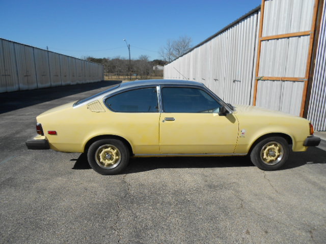

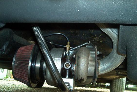

pic of one of my VE pumped cars ,Opel 1.8L turbo add on, it worked well, but not a fast hot rod by any means!

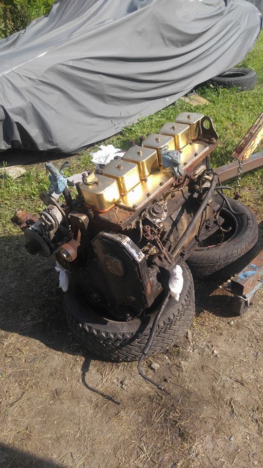

Update!
Headgasket installed and valve covers / intake log all cleaned up! I kinda love this build right now, im sure it's going to **** me off sooner or later though. More work to come. Gonna do tappet cover, timing cover, filter housing and oil pan gaskets next. So far did exhaust gaskets, intake gasket, valve covers and head.
Going to try to convert it to rear sump so i can mount it further back into the car.
