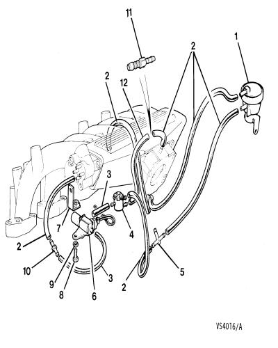

ok while im waiting for the tps,I found a small part under right rear intake,just under all the vacuum spouts that are at the end of right rear intake.It says nippodenso and has a vacuum line on it that t's onto one of the vacumm lines at rear of intake.It has two wires that come out of it,that are disconnected.They must go somewhere.
anyone know?
thanks
Old Jul 1, 2014 | 03:12 AM
  #177
Posts: 28,829
Likes: 11,288
Your market is sooooo different from ours, but maybe the item # 6 "dump valve" in the attached diagram is what you have.
I think" the wires are attached to a temp solenoid for vac advance/retard whilst warm up is under way, but NOT 100%.

i believe that the best thing to do with that cat's cradle of tubes is as follows:
  • Find the vac tube from the advance/retard capsule (the capsule is on the base of the dizzy pointing rearwards)
  • Suck on that tube. if it sucks air then the capsule diaphram is toast and needs to be replaced or fuel economy crashes
  • If/when the tube holds vacuum, then connect directly it to the small take-off underneath the A bank throttle body
  • Blank off and disconnect all the other little tubes that are part of this system.
I did this years ago on the advice of the great David Marks, JEC guru, and it works just fine and removes lost of unnecessary complexity.

yep,looks like it,#6 Its hooked to vacuum but wires go no where.
My vacuum advance on dist is froze.but good advice on eleminating everything but advance.My air pump is hooked up and running should I leave it,or take off belt drive.And what about egr valve?
