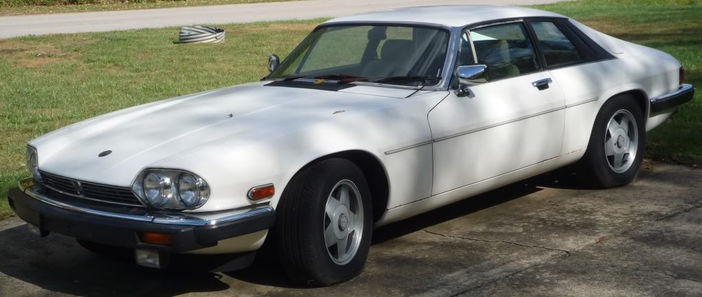

alabbasi's Avatar
Posts: 482
Likes: 97
From: Dallas TX
I like the wheels. I think that they're Borbet A's which were sold in the 90's
