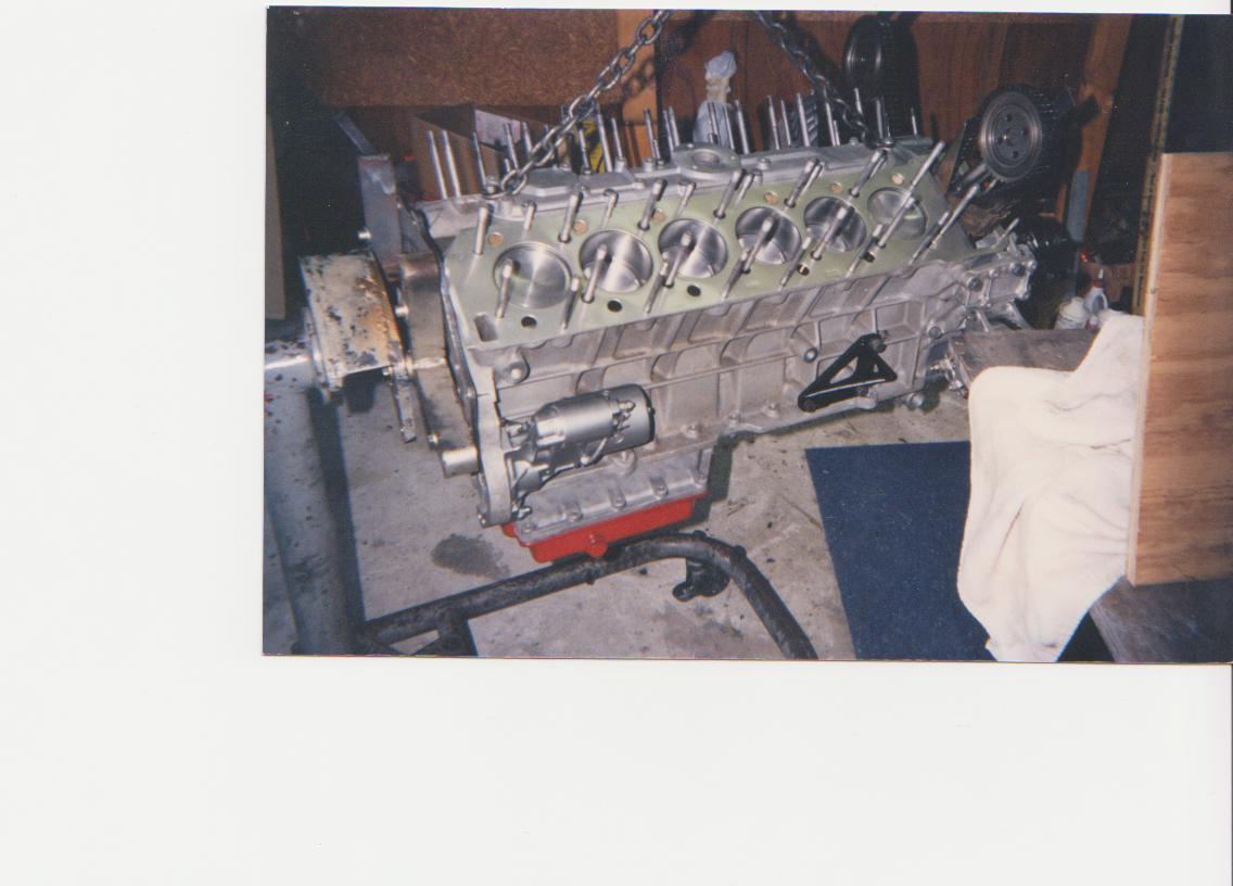

danny; the half-moons are a simple project, compared to the rear main seal!
and nobody i have ever heard of can make the early rope seal engines leak proof!
i did mine(taking very careful time and effort), and it did not leak for about 2000 miles, then slowly at 1st started leaking, and got progressivley worse as time went on!
the Group44 race guys did all types of fixes, finally used a 2 piece Chevy neo seal,but had to machine the rear of the block amd custom a make a plate to bolt to the block, worked fairly well for awhile, but it proved to be a headache area.
in the end, Ford cast a new block(altho using some tech from TWR racing),
it also requierd a different crankshaft, an expensive change at best.
and someone mentioned the crankcase breather system,YES very important to be sure its working properly , i increased the case vacumm by changing PVC valve,so as to try to keep case pressures negative,HOPING to hold oil in, my engine now has 0 leaks ,except for the rear seal!
anyhow my 1978 XJS V12 leaks oil from the rear seal, been 20+yrs, and i just put a catch plate under the car, and say to hell with it!
Attached Thumbnails 1987 XJS Rear main oil seal-jaguar-engine-build-process-001.jpg   1987 XJS Rear main oil seal-jaguar-engine-build-process.jpg

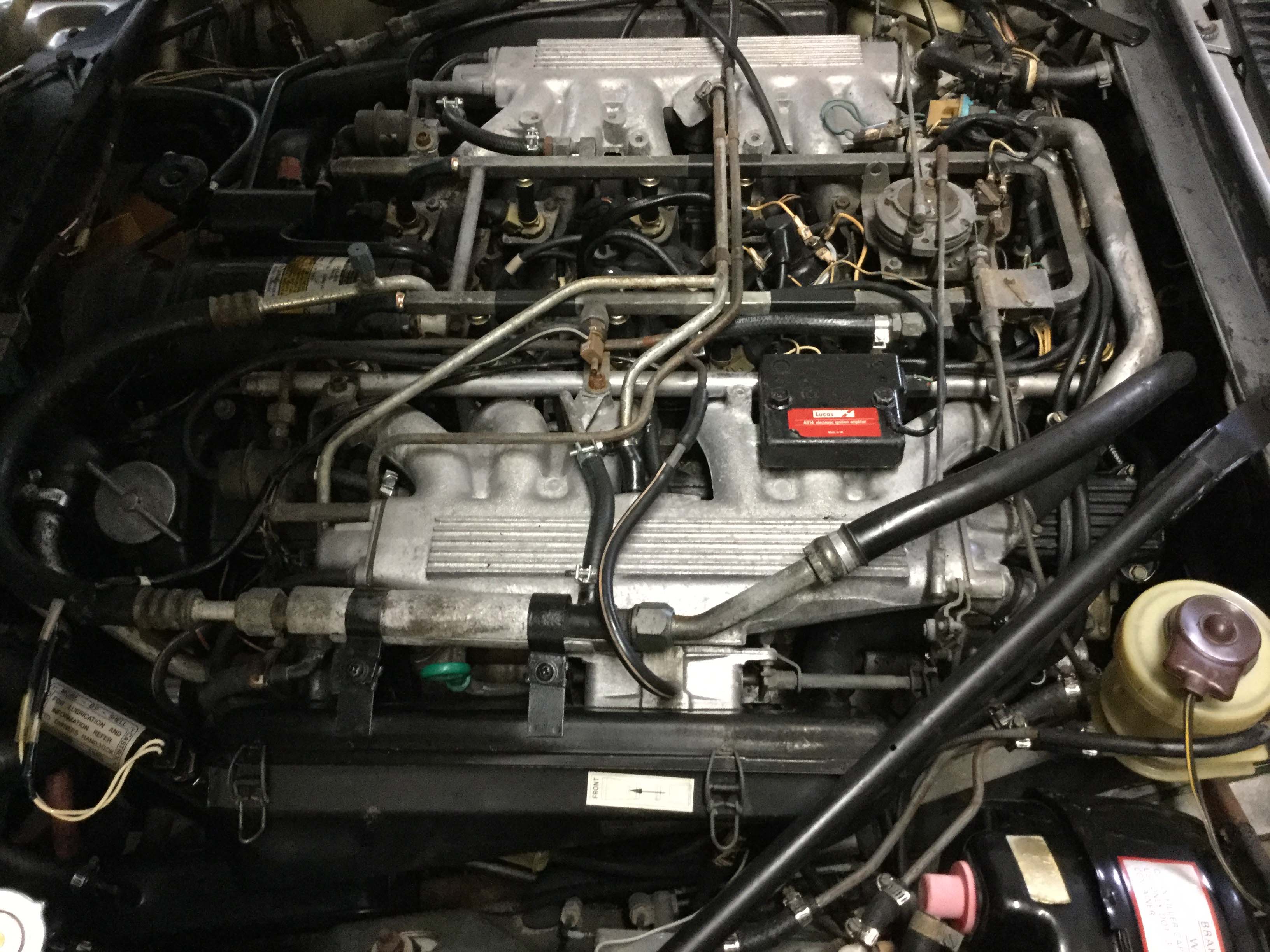

Hello, i have problem with oil leaking on my XJS V12 1983. Is this rear main seal fault?
Oil leaking
Old Feb 27, 2017 | 03:49 PM
ronbros's Avatar
Joined: Jul 2010
Posts: 7,362
Likes: 1,241
i have never in 25yrs seen an 1989 and earlier Jag V12 not leak oil from rear seal area!
as said i was very carefull when rebuilding V12 , and it did not leak for about 2000mile.
then slowly but surely it kept getting worse, TWR suggested run engine oil level down about 1L, or about a Quart!
make sure PVC system is in proper order!
i still put a drip tray under car after a run, let go over night, is about the best we can do without R&R engine & transmission!
i'm told Ford/JAG v12s dont leak rear seal .
