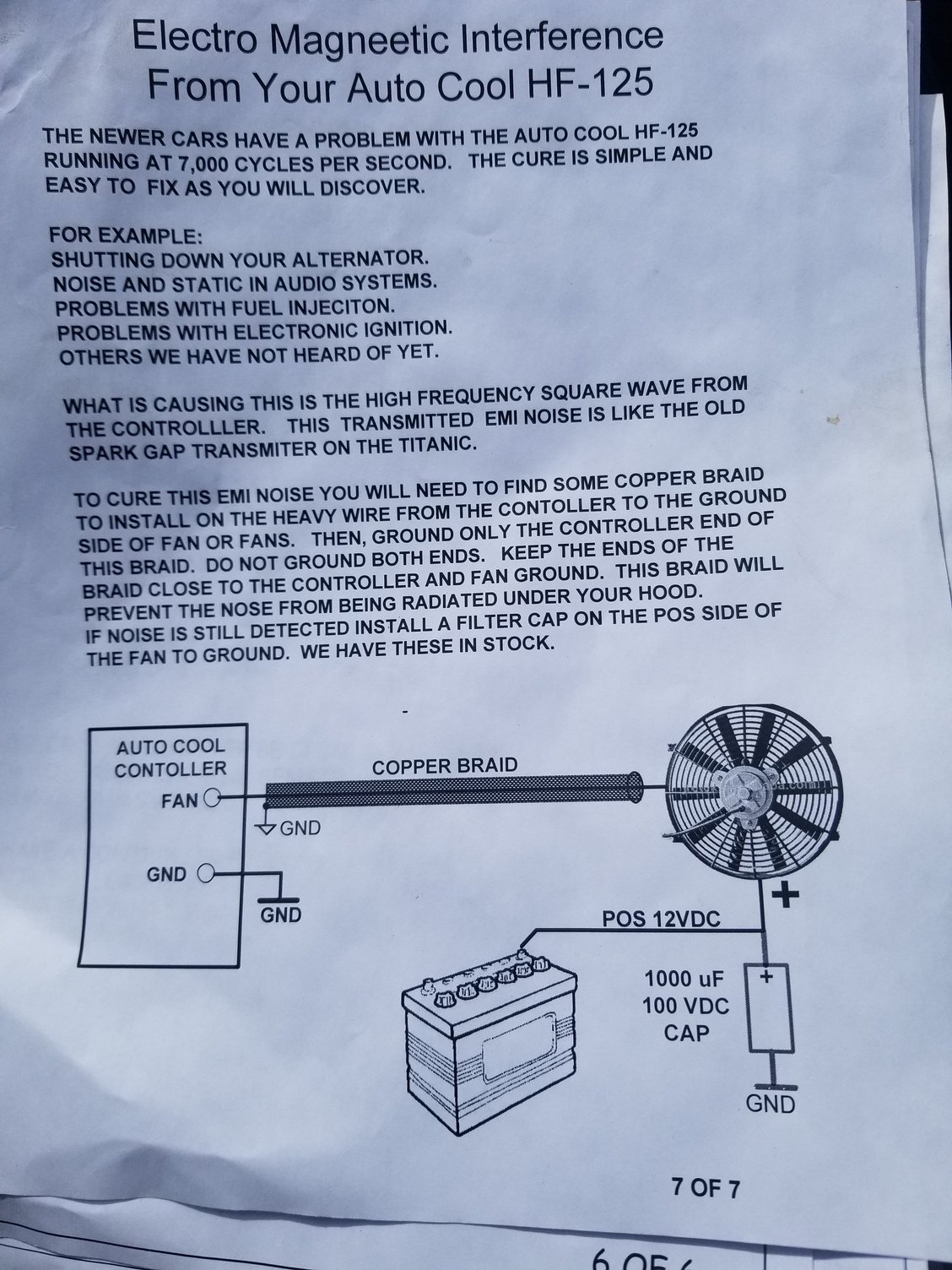

I need y'all's big brains. I am sure I am experiencing what is described in this document from the Auto Cool Dude. Interference.... Strange things are happening with the idle when fans get going.
I want to shield the line.
I want to include the capacitor.
I want to be sure. How do I do this?
Walk me through it?

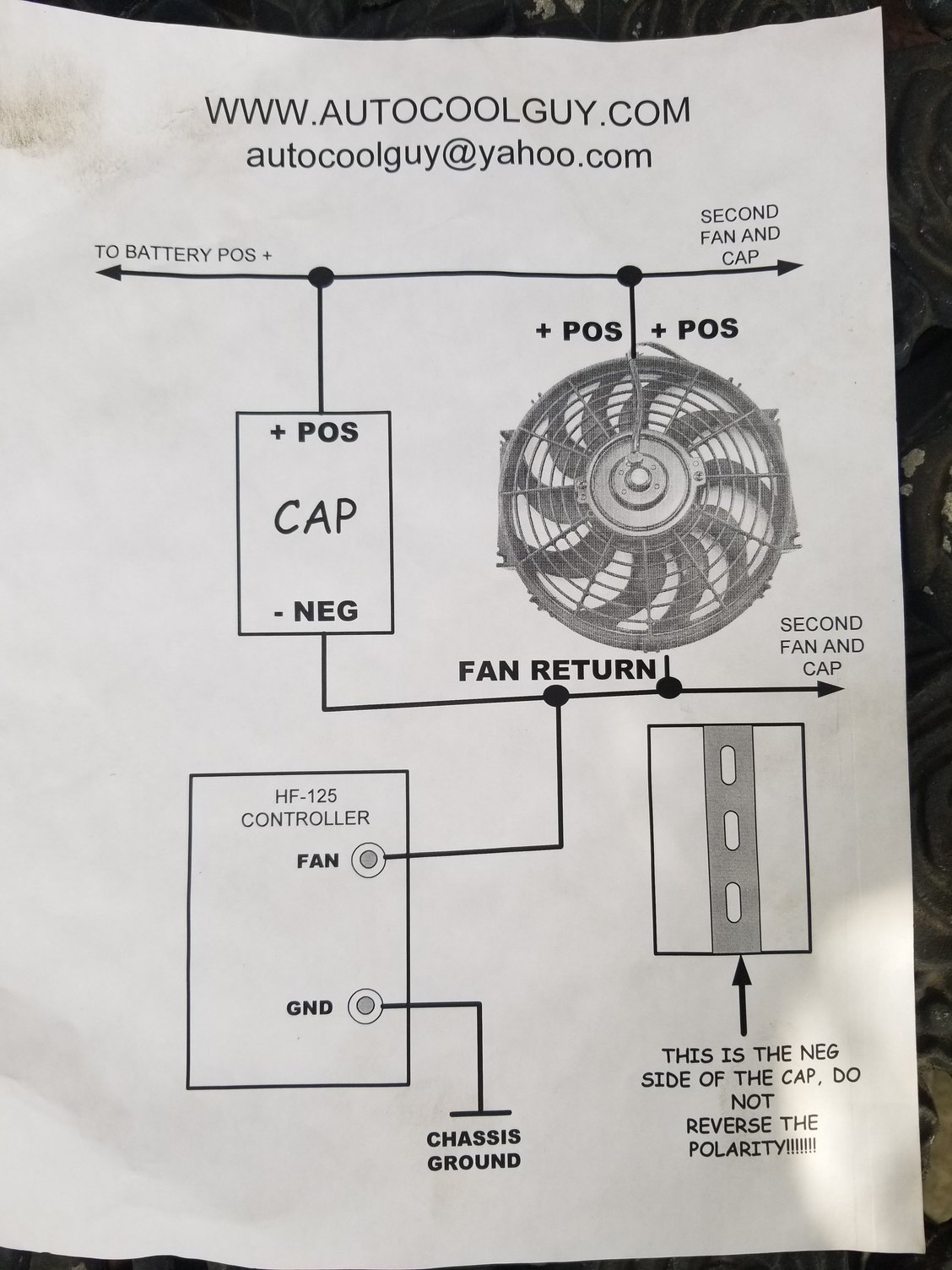

This is what I got so far.
A bit more work to do.
But things seem ok at this point.
See what happens when I start down the road 😜
