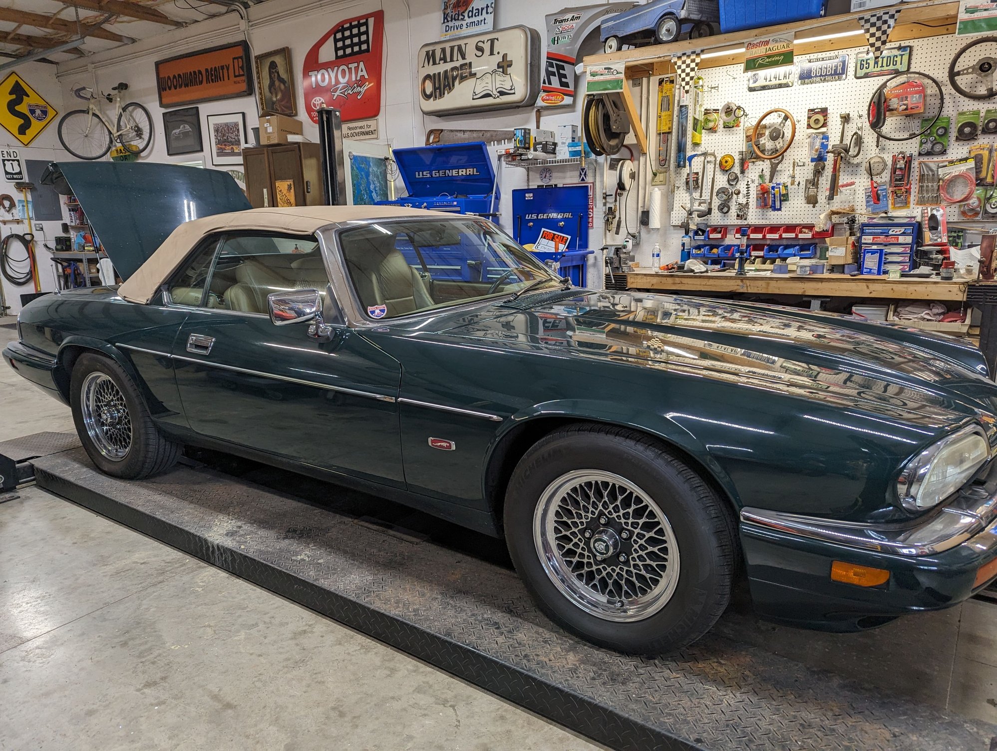

Greetings! I just purchased a new to me, 1995 XJS 4.0. This is my first foray into this model jag and am slowly learning the nuances of its operation.
One fault I have noticed so far, is that when using the heat, I only get hot air from the vents when the temperature dial is set to full heat (85 i believe?). Any amount less than that I get cold air blowing through the vents. I looked through the forums and did not find anyone with a similar issue. Where should I start with diagnosing this issue?
