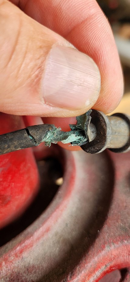

From what I've seen, all these speed sensors from this era are falling apart. ie the rubber that coats the coax that they're made from is deteriorating and exposing the coax cable to road salt etc. the coax then deteriorates to the point you now have an open connection. The simplest way to determine if its the speed sensors, is to just take an ohm meter and measure it right from the pins on the ABS module. you can do all four in a minute, they (as I recall) should be around 1.2k. Download the electrical pdf and find the correct pins.

I have a 1996 that is not garaged and I daily drive it in the Washington DC area. The wheel speed sensors have a very thick and durable insulation on it. I've seen no such degradation on mine. The one that I replaced certainly looked healthy.
Now perhaps the 1994 uses a different sensor?
I suppose that is possible. Jag may have reformulated the rubber at some point as I've never seen automotive cable deteriorate like this...I've looked on ebay too at used sensors, and they all seem to have this deterioration at some level. (at least for my model year)
