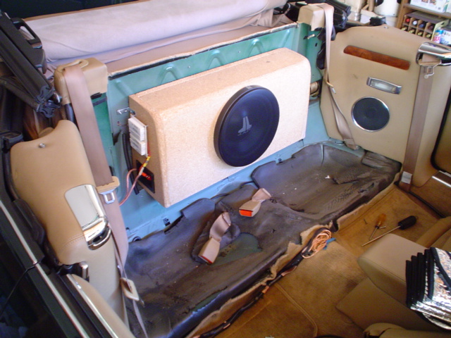

What I did on my XJS is actually rather unique, but it does imply a bit of labor. The sealed enclosure driver is actually located inside the rear seat back cushion with a "port" at the bottom to help sound travel. I do not listen to "boom-boom" music/noise, so I do not need so much sub, but even with classical music it is awesome to have accurate below 100Hz frequency reproduction, so this is what it looks like without the cushion:

Forcedair1...what jl audio sub is that and how did you mount the enclosure to back? isn't the gas tank right behind the rear seat?
No problem, as with screws at all 4 corners, the "L" brackets holding the eclosure do not really need long screws, no more than 3/8", just gotta make sure that they're real tight and secured, so they won't come loose. My driver's model # won't do you any good because I opted to use a sub of different impedance for which I had to develop a resistive network in order to match my subwoofer's 4 ohm impedance, but it sounds great. But there are plenty of excellent subs out there, plus if I had to do it again I would like to try, for once, some of these newer flat, (as in under the seat) powered subwoofers that are supposed to be surprisingly good, plus one heck of a lot easier to install. I envy the XJS with the interior trunk, it'd be so easy to do wonders with your stereo.
