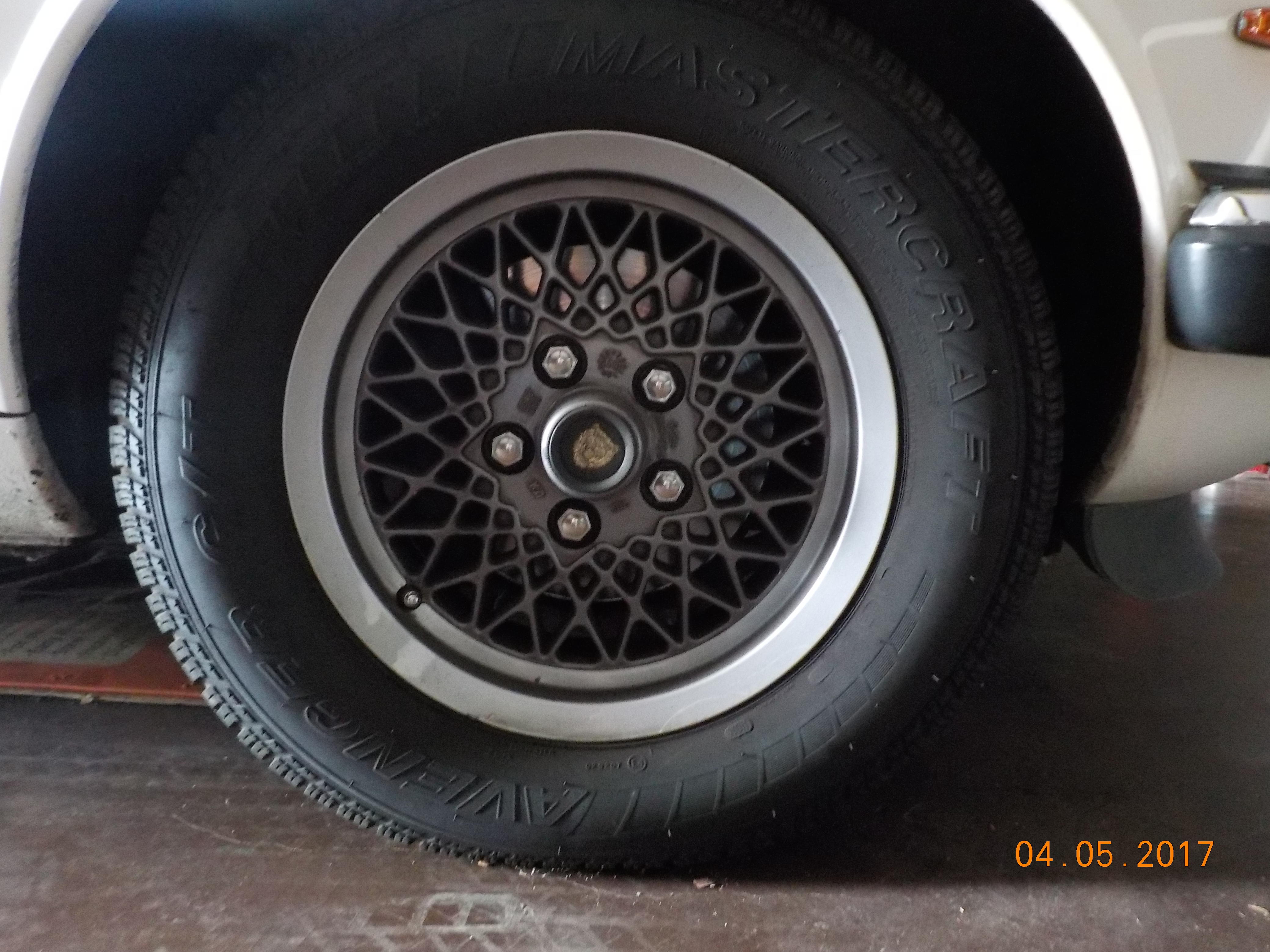

Hi JigJag
yes running Mastercraft avengers as i could not get the original pirelli tyres.
the tyres are OK.....will be looking at 17"rims down the track.
some pics attached
Rgs
Darren
