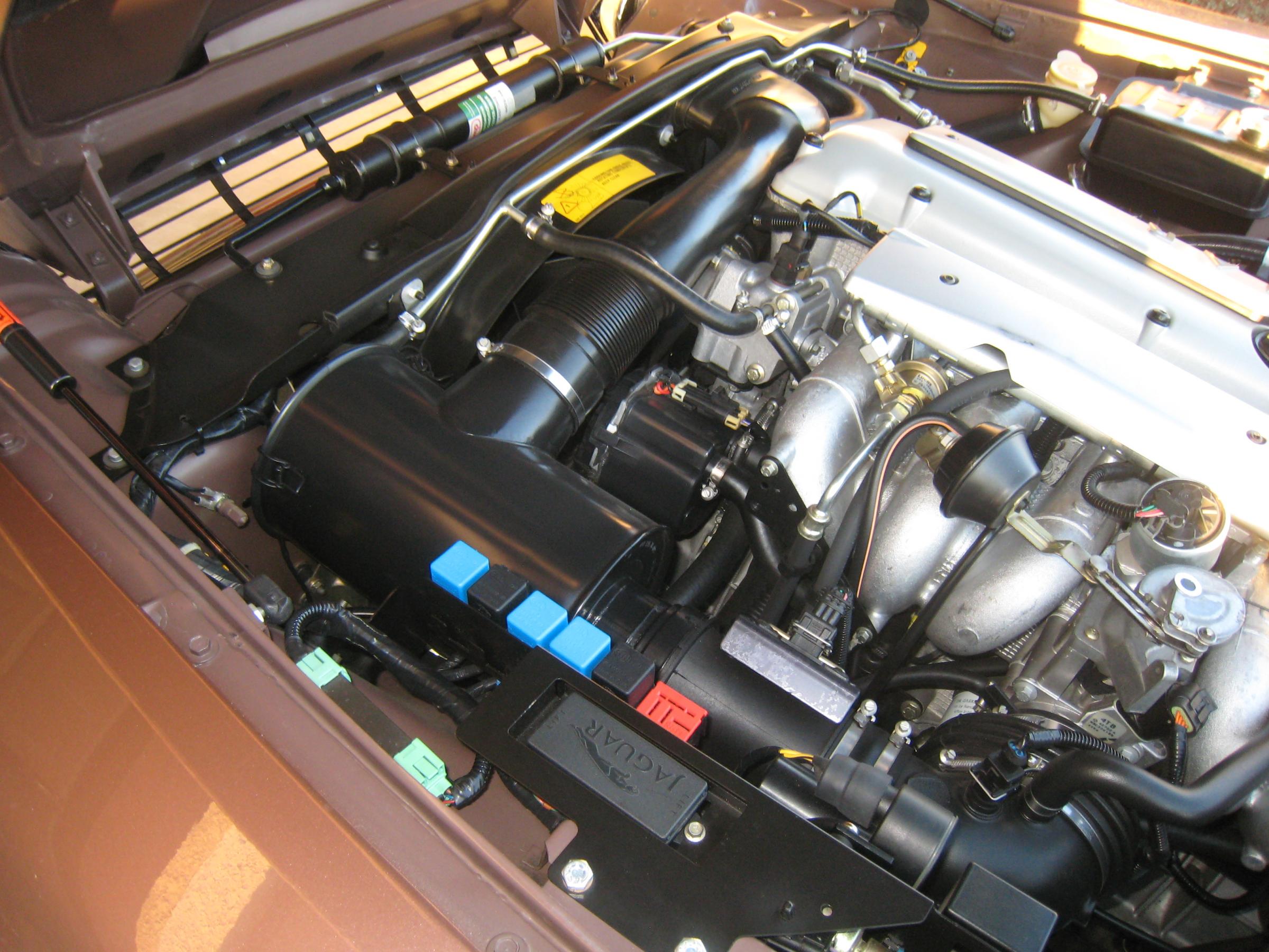

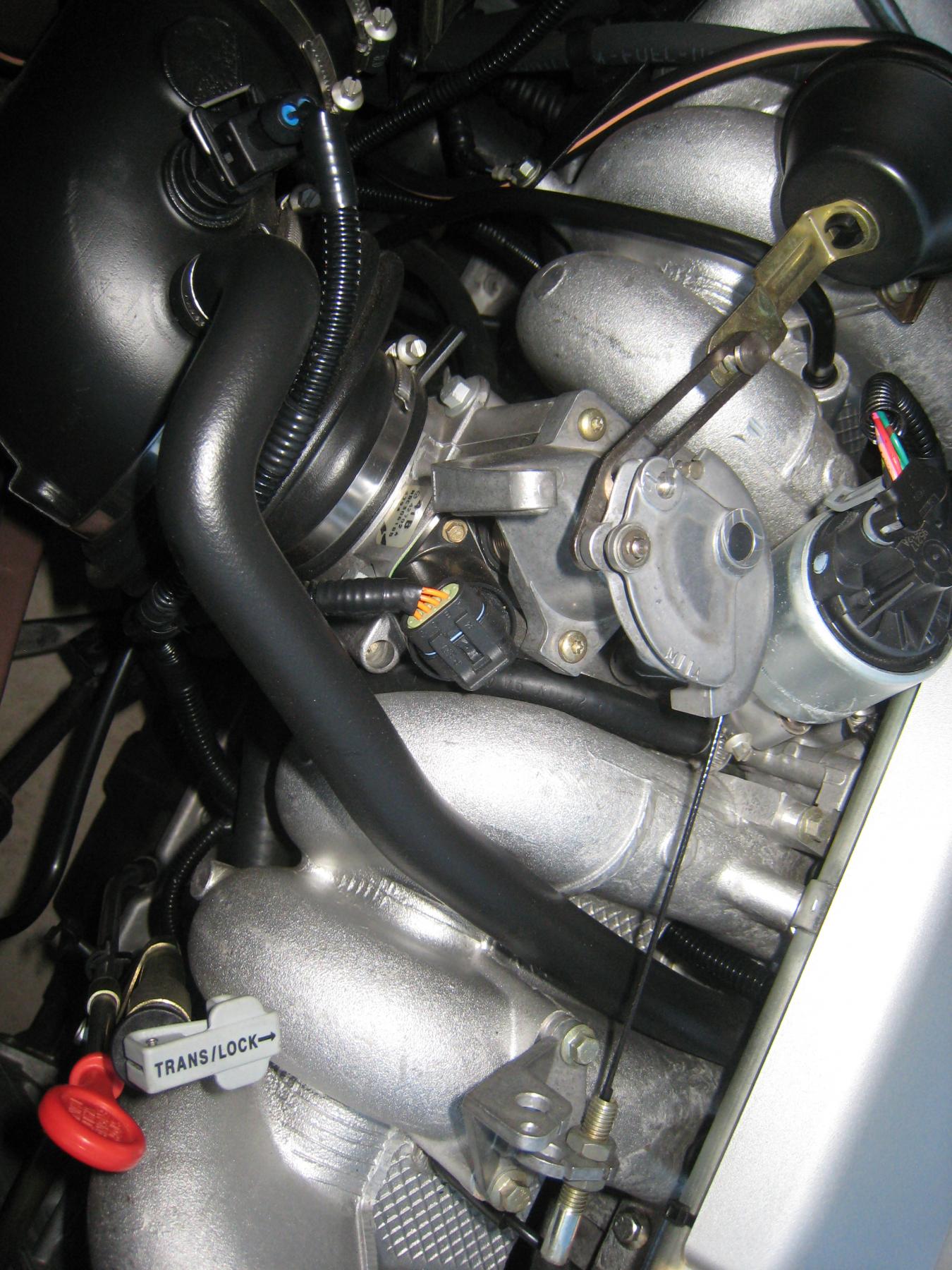

Hi guys, I'm more of a regular over at the XK8-R forum. But I may be spending a fair bit of time with you all in the future...
I'm considering buying a '95 XJS 'vert for my wife - for her birthday. I have my eye on a nice 99.8 point concours car (Rose Bronze) with 36,000 miles. From a local Jag club officer. I drove it yesterday, and it drives out really nice (no surprises there) but the oil pressure gauge is all the way over to the right and doesn't budge when the engine is running. He says it has always worked in the past and it wasn't until he had wiped down the engine after a recent 160 mile trip that it "quit." He thought he "must have pulled a wire out or something." After I drove the car, I reached under the intake manifold and felt two sensors one to the right and another left of the oil filter and the wires attached to them. Nothing was loose. I pulled each wire from their respective sending units, then re-attached them with no effect on the gauge what-so-ever.
What do you think? Did he pull at wire loose or is he pulling my leg? Is the best chance, that the sending unit is just bad? This man is honest to a fault, so I do believe that he either didn't notice that it wasn't displaying pressure as he drove it last, and/or he really thinks he accidentally pulled a wire.
Cheers!
-Barry
