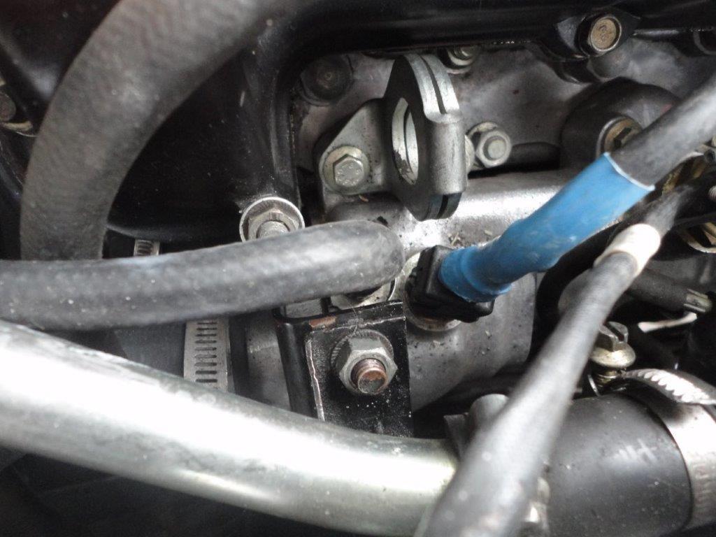

I gtried three things today. based on "So Ya got a HE V12 that won't start". First I replaced the Coolant Temp Sensor with a spare. I compared resistance readings between the two pins. The one in the car read .002 ohms. The replacement read .004 ohms.
Connector with blue heat shrink plugged onto the Coolant Temp Sensor

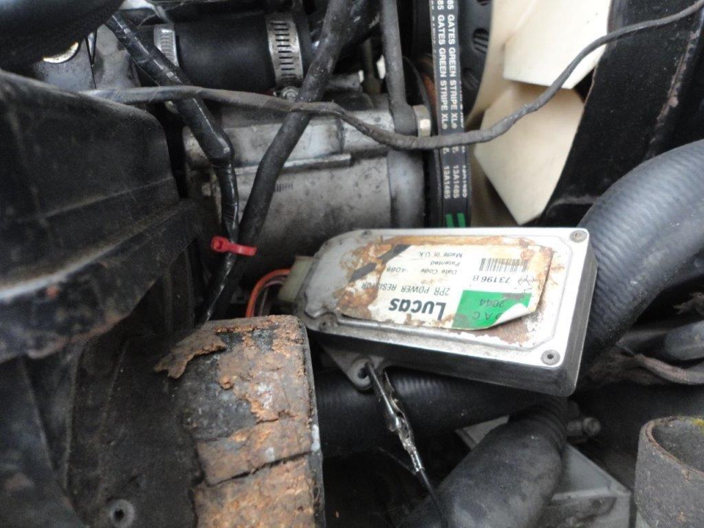

I also placed a spare Power Resistor and used a aligator clip jumper to ground the case..
spare power resistor connector

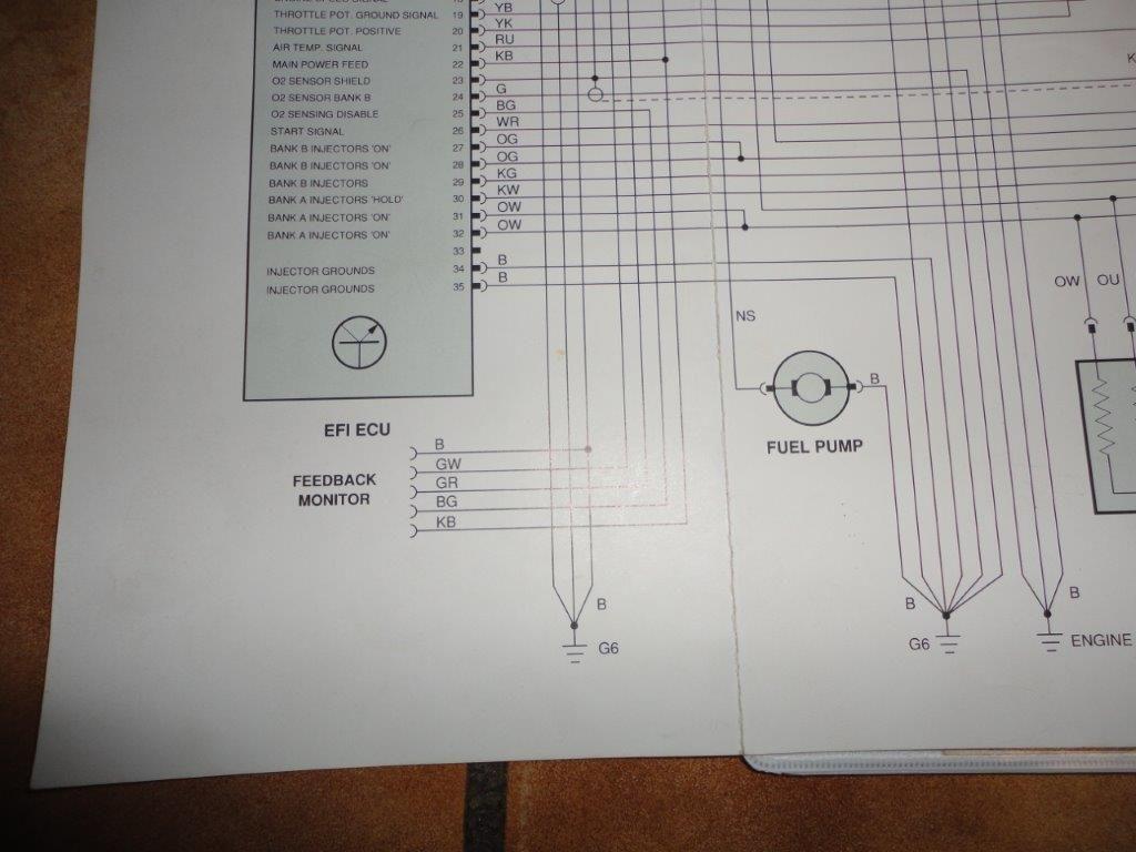

I checked pins 16, 17, 34 & 35 and all are showing 0 ohms to ground.

I verified continuity from the Red & White wire at the Starter Relay to Pin 26 of the ECU and then confirmed voltage to Pin 26 with the Mrs attempting to start the car. I tried the test with the with the ignition on and turning the Throttle turntable to wide open, but did not get any injector clicks.
I also confirmed power to Pin 22 of the ECU with the ignition on while the Mrs attempted to start the car.

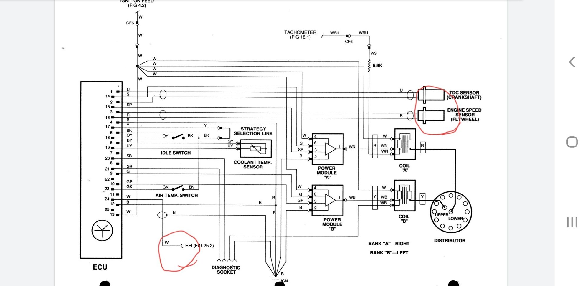

I think, and this is just me, that you are going to need to be paying attention to the info in this diagram...
Are you sure that both the crank position sensor and the fly wheel position sensors are good, that the wires are intact and that there signal wires are well grounded and making it to there respective ECUs?
Also, that grounds are clean and well fastened in the engine bay and back by the battery?

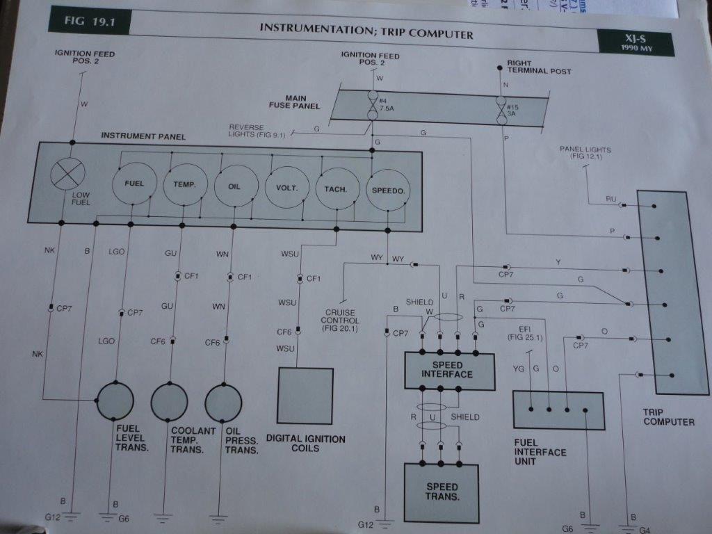

Both sensors are new I had checked/confirmed that the white wire from Pin 24 of the DI ECU connects to Pin 18 of the EFI ECU, but will verify again.
I also checked the wires for the Fuel Interface Unit (Figure 19.1) Yellow and Greenwire that connects to Pin 29 (Pink & Green) of the EFI ECU. The Schematic for the Interface unit does not show what is inside, but the unit does connect to ground.

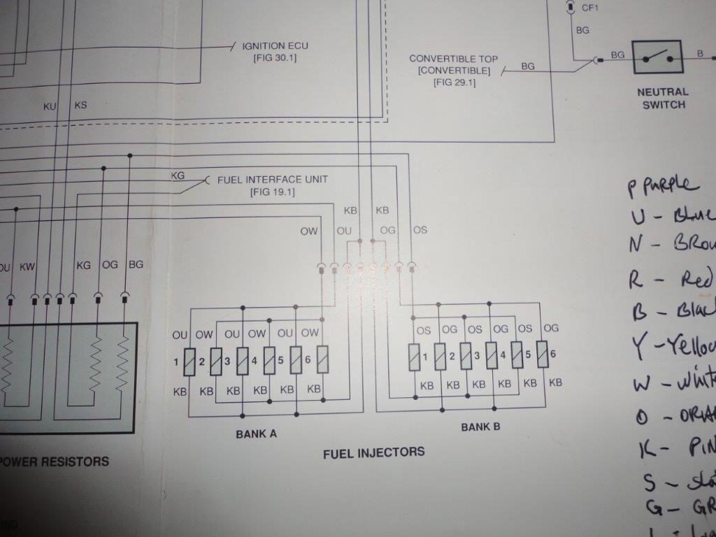

What I do not get is how the injectors get ground to complete the circuit for the injector solenoids to trigger. All the injectors get power through the Pink and Black wire of the Main Relay.. The other side of the injectors connect to Pins 8, 9, 13, 14, 27 & 28. So, it appears that the ECU completes the injector grounds through Pins 16 & 17.

The ECU grounds the injector circuit, as you surmise. Do you have 12v to the injectors? If so then the grounding circuit is the problem.

Yes. The ECU completes the grounds.
Have you made sure, as Doug suggested, that you have 12v to alllllll injectors? All of them?
Just FYI the Fuel Interface Unit takes info (injector pulse width) from the ECU and turns it into a language the Trip Computer can understand so as to give the fuel economy readings
Right. The injectors have 12v "+" with the key on and the ECU grounds them. The "Injector On" and "Injector Hold" circuits ground the injectors via Pins 16, 17, 34, and 35.
If you checked the injector wires with the key on they'll all show 12v "+" until the ECU grounds the orange/xxxx wires to operate the injectors
