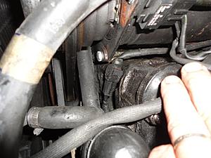

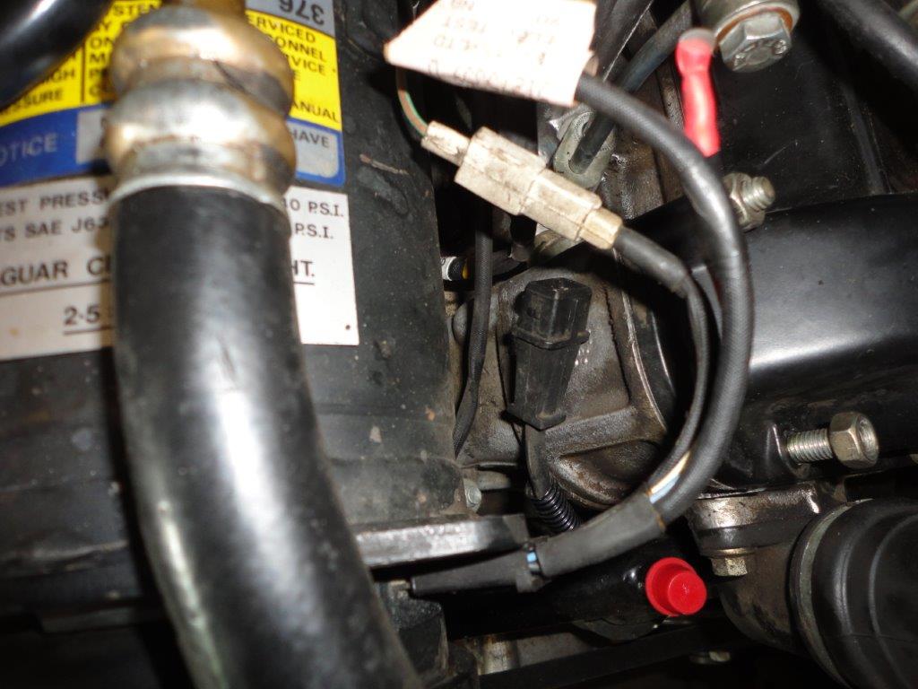

On the left side at the front of the engine, down in the Vee right beside the air conditioning compressor is a black connector for the front timing sensor. Disconnect and look at both ends for water inside. Any moisture or corrosion will prevent the ignition module from reading the signal and then you experience exactly what happens to you. Sometimes it is the pick-up mounted below the harmonic balancer that reads the fingers on the balancer that has gone bad.
What you describe as symptoms, especially right after using water under the hood (bonnet) points to the front sensor.

is there a pic or diagram pointing to this black connector for the front timing sensor?

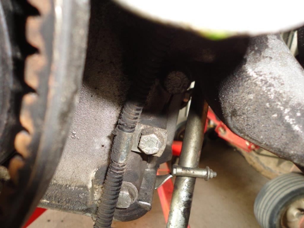

I took a few photos that should help you find the connector

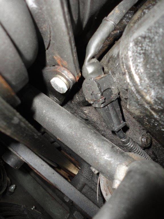

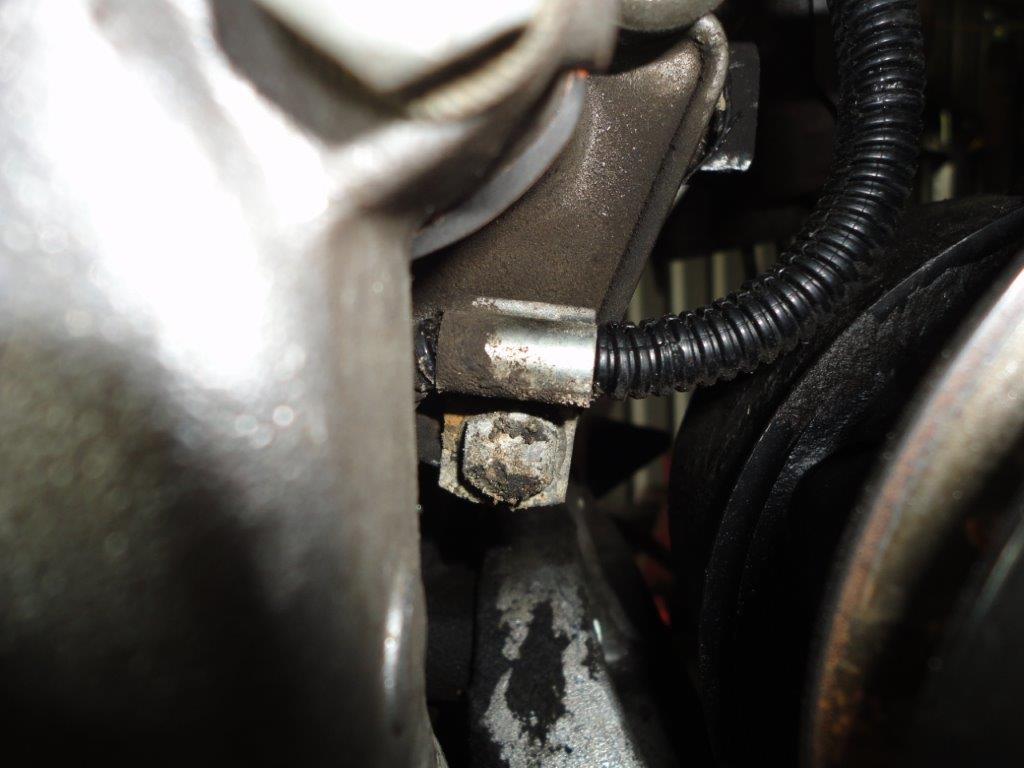

One further note on the front sensor. It is secured with two clamps on the front left of the timing cover. If you have to change one, don't reinstall the clamps.
There is nothing that will **** you off like trying to get the camps out of the way while on the side of the road.
Carry a spare sensor, a coat hangar and about two feet of twine. I had to snake the coat hangar from the top down and tie the twine to the hangar and the other end to the sensor connector and snake the cable from the bottom up. Keep a 8mm wrench as part of your tool kit to get the two bolts that secure the sensor under the crank.
