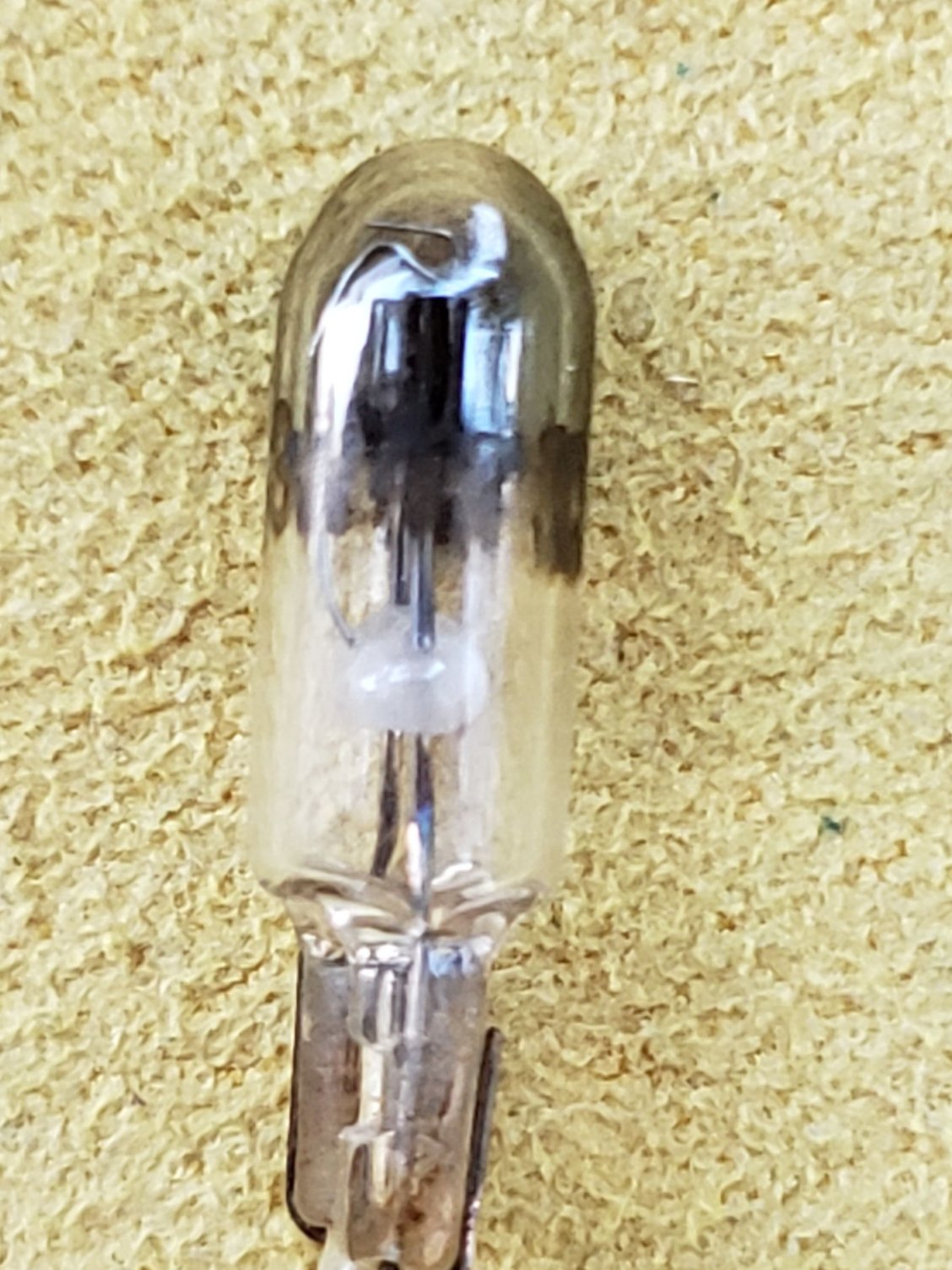

Looking to replace my rear lights (tail/brake) with LEDs, including the brake light strip mounted under the rear deck spoiler.
I verified that the bulbs used are 501 capless as mentioned in the owners manual, also known as W5W T10 bulbs.
I am working with Gil Keane of Better Car Lighting in the UK, he is trying to locate the correct LED replacements that won't trigger the dash bulb-out warning lamp. I've ordered some via Amazon to test in the meanwhile.
Has anyone here had success in accomplishing this?

Four of the seven bulbs in my spoiler brake light are out, tried to get some temporary bulb replacements until the LEDs arrive. However, what my local Advance Auto said would fit (2825) had a much larger base, so I didn't get them.
Any suggestions what LED will fit?
