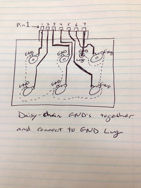

Update: I've found two options. This blog link describes how to simply test the valve block and how to use a less expensive XJ6 ABS valve block as a replacement, http://www.rennsportkc.com/jaguar-xjs-ate-abs-repair/. However, the measurements in ohms on the blog leads to an incorrect assumption. He states that bad valves will read 6 ohms while good ones read 3 ohms. In fact, inlet valves will read 5-7 ohms, while outlet valves will read 3-5 ohms when functioning properly. You should read 3 of each to total the 6 valves on this unit.
I was also just lucky enough to find an 89 ABS valve block on ebay for $56. I'm going to test my current one per the link instructions. I'll test the one I just bought before installation. I'll update you all on the results in the next two weeks.

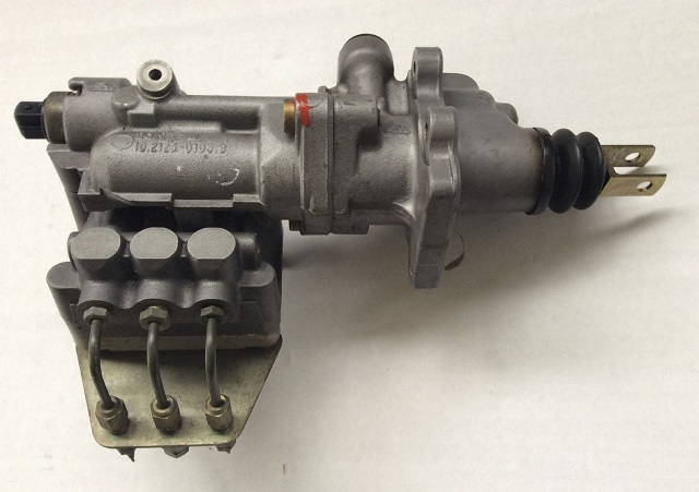

Over the weekend, I verified that it is in fact the abs valve block that is attached to the master cylinder. I measured each valve resistance, including the main valve near the front of the mc. Inlet valves (4-6 ohms), outlet valves (3-5 ohms), main valve (2-5 ohms). So, the valve electronics do not show any dead ones. Rule out electronics, look for a mechanical issue.
I re-measured them from the ECU connector in the trunk to verify the wiring harness was not at fault. What I was able to do was take the car out, run it about 5-10 mph on my neighborhood road and intentionally jam on the brakes locking them up to engage the abs. Since I had replaced the calipers and flushed the fluid twice, the brakes worked great if I used them gently. After about a mile the pull started to happen mildly. So, I was able to really see the effect. After locking them up, the one valve to the RH side (front) stuck, blocking fluid to that caliper. I put up the front and spun the wheels, tested the brakes to verify the RF was not engaging at all. To finally rule out the abs ECU (computer in the trunk), I rolled down a hill in my neighborhood with the car off. Be careful, that isn't easy to control. I engaged the brakes to find the valve still sticking with the ignition off, computer off. Result was determined the valve is in fact sticking.
There seems to be no rebuild option. I was lucky enough to find a used one on ebay for $60, while all the other used and new ones were $400+. I don't know at this point if the used one will work or how long it will last. I will receive that unit this week. I'm posting a pic here.
The actual valve block is the unit bottom left with the fluid lines coming out and it attaches to the master cylinder, coupled by 4 small O-rings. You can either replace the entire mc assembly, or just the valve block.
I did find this as a lower cost option:
"So at this point you have options. One way is to change the solenoids. Another is to buy the whole assy from a breaker. I found that even used the prices were very high so I chose option 3. I bought a more affordable ATE ABS/master cylinder unit from a 1988-94 XJ6. The block must be removed from the XJ6 master and I changed the faceplates. It looked like the spacers on the newer unit would have been ok but since all was out, why not go back to what was in the car. You must also remove the locator tabs from the newer 7-pin connector. Even though the pinout is the same for some reason the locators are different."

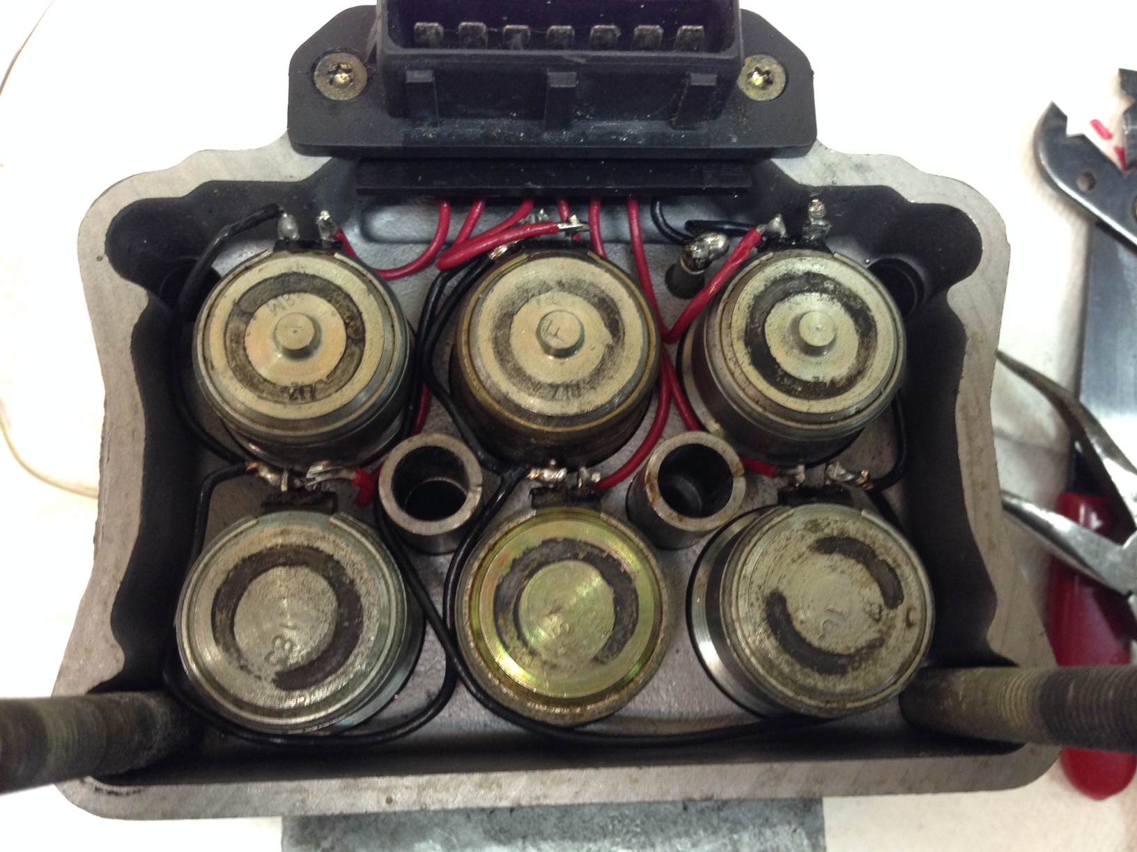

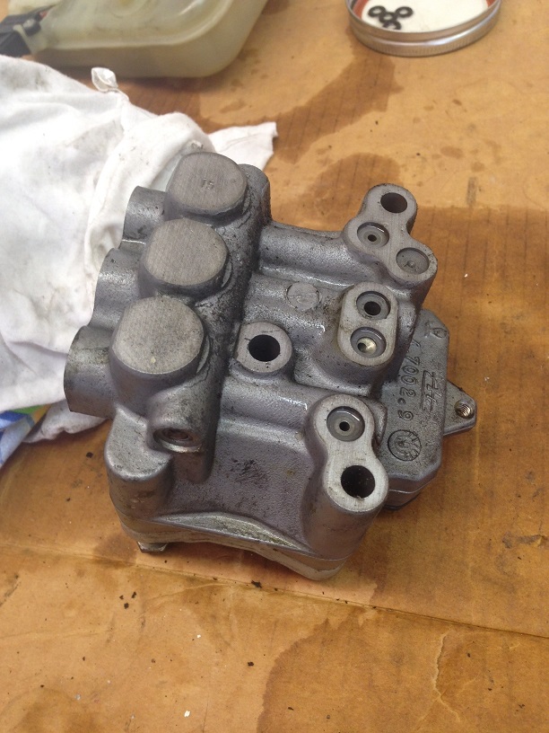

I've received the new/used valve block, removed and disassembled my old one, and am going to open the new one to verify the valve screens are clean before installing it. I've measured the valve resistance on the new one and it checks out. In valves measure 6 ohms, out valves measure 3.5 ohms. All 'click' when 12V is applied to the pins.
To my surprise, I found a missing or dissolved square edge o-ring that goes between the valve block and master cylinder. There should be 4, there were only 3!
Here are a few pics of what I have.

Some additional information to pass along: After opening up my old valve block, I found some cracks in the flex circuit to the valves that control the RF caliper. I'm going to post several pictures including the solenoid that was not working. I removed it and the flex circuit was so brittle, it snapped off. Assuming the 'new/used' block has the same 25 year old flex circuit, I removed the entire flex circuit, created a schematic of the wiring of the flex circuit and then hand soldered new wires in place of the old flex. I then measured resistance at the 7-pin header to verify the soldering job and schematic. I also connected 12V to pins 1-6 with gnd on pin 7 and verified each solenoid activated.
Currently cleaning out the engine compartment under the MC, going to touch up paint and then reinstall everything.
Attached Thumbnails ABS valve block fail, hard pull left-flex1.jpg   ABS valve block fail, hard pull left-schematic.jpg   ABS valve block fail, hard pull left-solenoid1.jpg   ABS valve block fail, hard pull left-rewire-valve-block.jpg

So I guess the obvious question is was that broken flex-circuit the root cause of the failure?
Marty......................
Old Apr 9, 2014 | 04:06 PM
djinaustin's Avatar
Posts: 40
Likes: 23
From: Austin Texas
That broken flex was on the solenoid that controls the RF caliper, so I'm pretty certain the intermittent voltage on that puppy burned it out. It was sticking open prohibiting brake fluid and pressure from being applied to the RF caliper. Under normal conditions, that is what it is supposed to do very quickly for the front and rear wheels. I know it was stuck open. Why? I can only assume from what you can see in the images.
I am sure the old cracked flex didn't help the situation.
I can't believe they only designed the parts to last 25 years. That beauty is just entering her prime...
