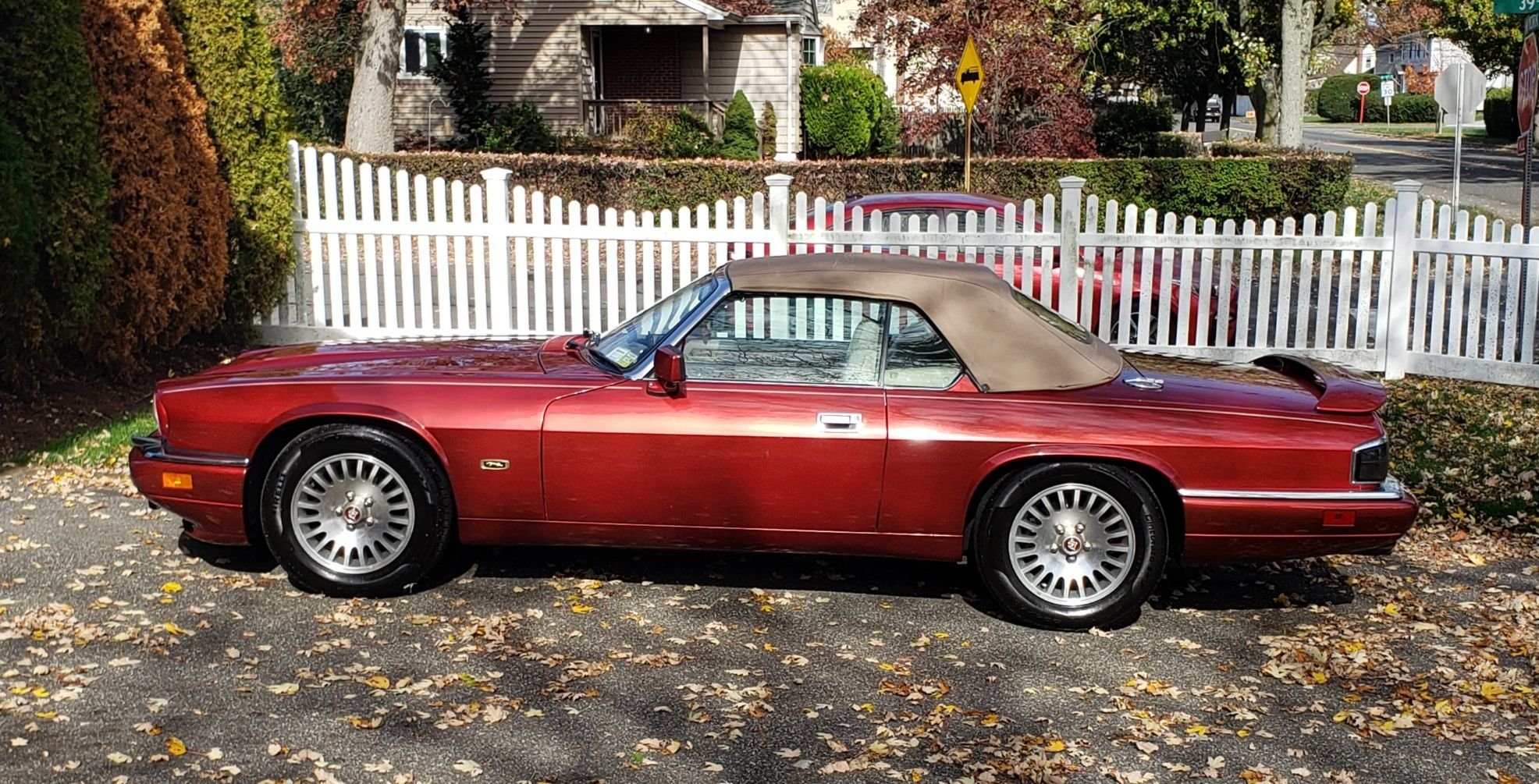

Gratuitous XJS photo. The shop washed the car, but they never quite get the glass clean, and make the tires too shiny...
