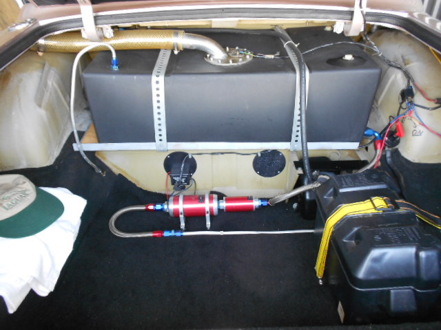

YUP been there done that,some of Jaguars not so great engineering!
so made some small changes to the fuel system.
Attached Thumbnails help...leaking fuel tank...-trunk-xjs-fuel-system-union-jack-001.jpg

I used to be into Classic American trucks. If you check out an issue of a Classic /Custom truck magazine you will find numerous suppliers of new fuel tanks in different configurations. They might have something off the shelf or that they could customize to your order. Ronbros, that's a good looking set up, did you post a thread on how you did it?

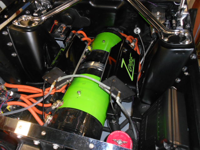

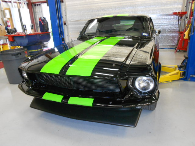

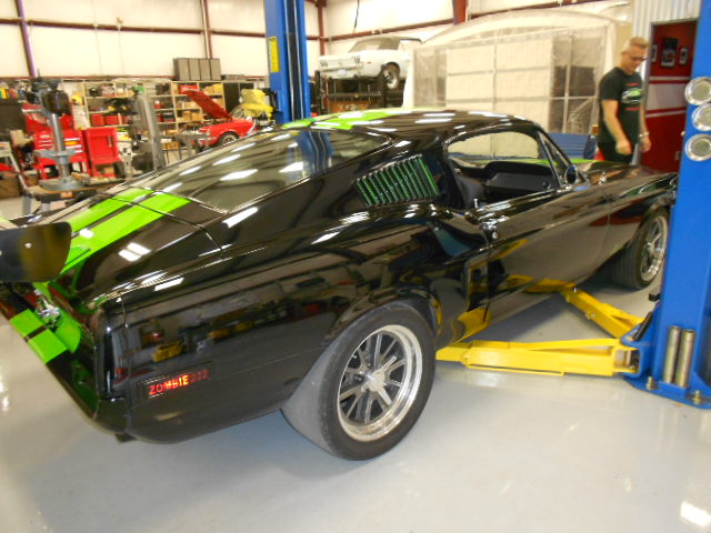

local guy with a 1967 fastback Mustang,pic
full electric, gave me a ride, absolutely incredible, 0-60 1.94 seconds!
Attached Thumbnails help...leaking fuel tank...-electric-mustang-001.jpg   help...leaking fuel tank...-electric-mustang-003.jpg   help...leaking fuel tank...-electric-mustang-002.jpg
