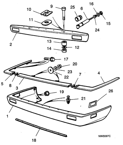

Two things... don't use Bondo. It will crack and fall off. The correct repair is SEM 68422 Plastic Bumper repair. To better brace in the broken section, get a piece of scrap bumper cover from a junkyard or auto body shop dumpster. Glue it all up from behind. I broke my XJS bumper cover all the way, into two pieces. This stuff is holding fine after a cold NH winter of use.
Second, the chrome hump... there's a weak plastic tab underneath. Take the chrome caps off and you'll find it broken. That's what holds the thing level and should be replaced with something stronger .

Are you talking about Part #8?

Yes I think it's the underside of #7/8. It like slips between the bumper cover and the bumper bar and holds the chrome close to the bumper cover. But this was the front bumper I'm familiar with, never had my rear off.
