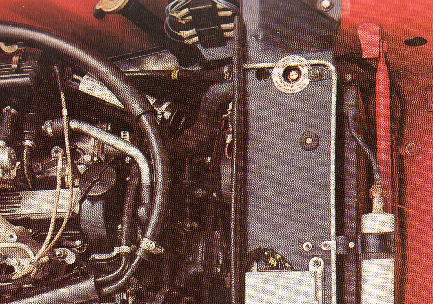

Not quite, but close!; this is my method as posted in this thread, post number 8. It is not really any different from what you guys do, but spelled out a bit for people who are new to the terrifying-looking HE cooling system:
https://www.jaguarforums.com/forum/x...r-help-185295/
  1. park the car on a slope nose up, or jack up nose a bit
  2. remove both caps and top up at centre cap until water starts coming out of the wing tank
  3. replace wing cap and keep topping up the centre and replace centre cap when upright tube full
  4. turn heater control to DEFROST
  5. start the car and let it tick over for a couple of minutes
  6. on the LHS (US driver's side) of the rad is a brass plug (at least on all OEM rads) roughly in the opposite position from the banjo bolt.
  7. remove this plug and let air bubble out, squeezing the top hoses is a good idea to aid this process. If air is in the rad and no more bubbles, pour coolant into the bleed hole
  8. turn off engine and top up into this bleed hole if necessary and replace the plug
  9. remove centre cap and top up to the top of the upright tube.
  10. remove wing cap and top up if needed
  11. check centre cap level and wing tank level after doing a decent 20 mile drive after the car has cooled.

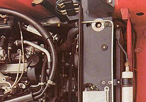

the way I do it is take off or out the bleed screw, and via the expansion tank keep filling until water runs out of the hole, that's it and it has always worked for me with perfect cooling.
