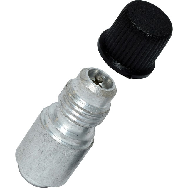

I
'll try it. is this picture of the charging port?

Your 94 could be either R-12 or R-134a. I'm not sure when Jaguar changed, they were not required to change until 1996.
R134a ports look like this
R-12 ports look like this
The R-12 have an external thread and the R134a have an internal thread. If your car uses R134a, you can get a recharge kit at any auto supplier.
