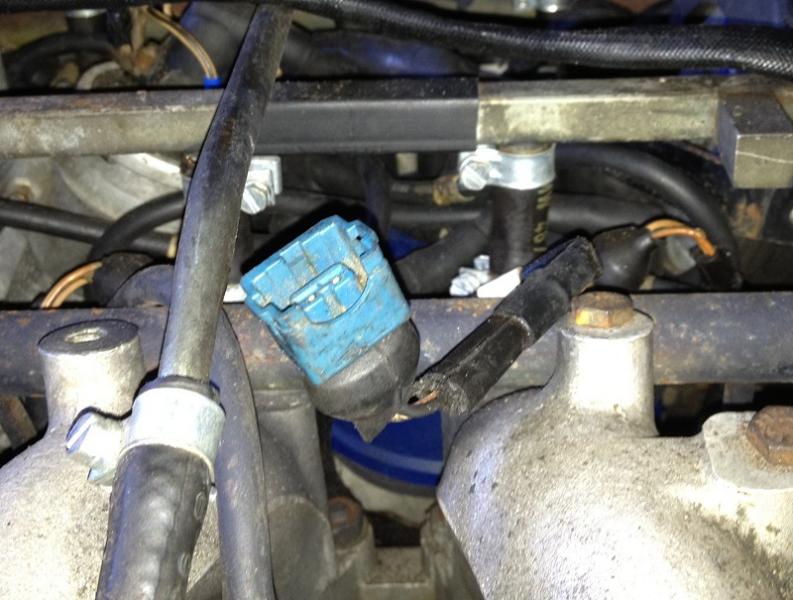

Paid a little attention to my cat today, mended the coolant fluid leak (a rubber hose on top of the water pump) and magically fixed the charging problem, simply by replacing the battery with a new with the correct spec.

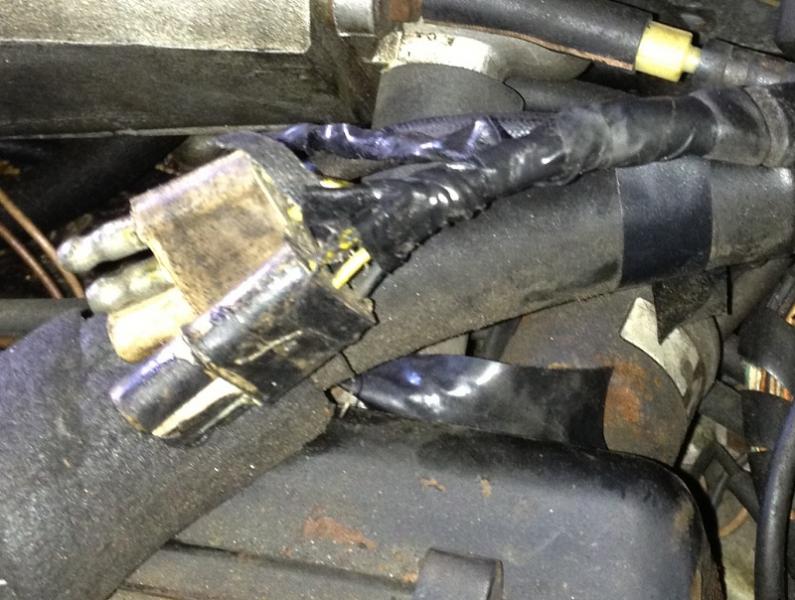

But when done with this, i discovered a "thing" with some harness not conected to anything else (se first photo). This blue "thing" has an adjustable knob, a strut for what i guess is to connect a vacuum tube to it, and some el. wires ending in two sockets (second photo) not connected to anything. does anyone knows what this is?

#1 I think this might be part of the cruise control vacuum system. In fact, it was probably installed as part of a recall. Some sort of dump valve?
#2 Possible cruise control wires? is your cruise control still in place?

Thanks for answer, and Yes - cruise control is still in place, but have not tested if it works...
