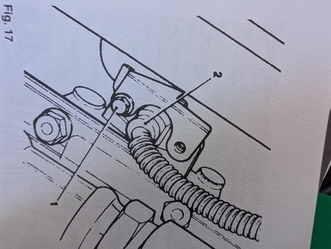

I was going to ask the admin to delete this thread, but decided it would be a good one to have easily searchable and just focused on the R & R or the CPS. RickE helpfully posted the pages below on my other thread, which helped a great deal. I have some additional tips that make things easier:

I found my cables for both the rear and front sensors were held in with clips; 2 P clips on the front from memory, one of them right behind the large coolant input hose so near impossible to get to, and because the sensor heads were larger than the p clips, and the old sensors had corrugated plastic protection, the 'draw string method' was literally impossible to do - I just removed both and carefully routed the new ones.

Since both the sensor head and the harness plug are larger than the P clips, the wire and it's plastic sheathing have to be removed from the P clips whether using the string method or manually routing.
