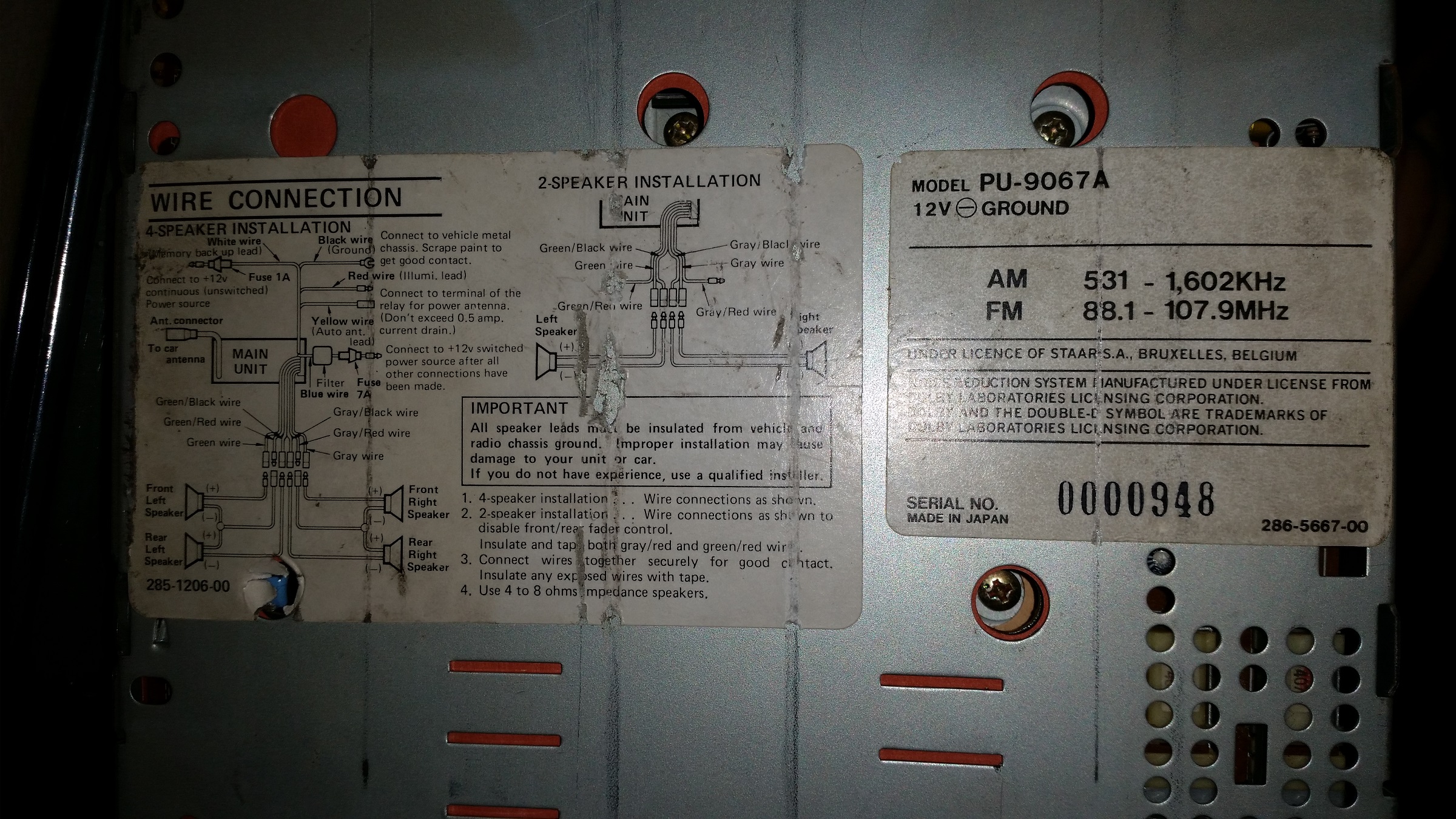

Well, Im gonna attempt this next week. Rip out the ole Cassette deck and install a new Mp3 (maybe pay more and get blue tooth) player.
So I took out my deck and the first thing I noticed was its quite chunky compared to new players. Its about 180mm long and 50mm high. The first thing I thought was the space left around the edges when I install a new one.
What is the best way to blank this up with it still looking classy?
Also I was looking at the wiring. Lucky for me they placed a sticker on the bottom of the player which denotes what each colour wire is for.
Just hoping we have a similar colour code for the player I choose next week. I am guessing it would come with a wiring harness, so looks like Ill have to chop it off and splice the wires.
So...according to the wiring layout we have:
Yellow: Auto Antenna
White: Memory Back up (constant 12V)
Black: Ground
Red: illumi lead (what the hell does that mean?)
Blue: connect to 12V switched
The grey wires, each with a different stripe : speakers
Any further advice on types of head units or how to blank up the sides if indeed if the new player is smaller, will be most appreciated.
Also any advice on how to tackle this best, I'm all eyes.
Thanks in advance

red: illumination lead - I would imagine this tells signals the state of the lights so the display can adjust accordingly.
Just a guess, I am not a stereo installer.

as in brightness of the display Flint?
Im wondering if some of these wont be able to be wired up on a new head unit. Such as the wire for Auto Antenna, as obviously not all cars have this feature. Maybe the same for the red wire?
I really need to get my hands on a new unit and check it out. See what wires are needed.

Originally Posted by paulyling
Where is Jake21? I am about to jump in the deep end and might need his help!
Try this.
Sean's Jaguar Tech Pages - Stereo Installation Instructions for the Jaguar XJS
Or
XJS Stereo wiring
There is plenty of info out there!
Pay more, you won't regret it. Bluetooth is a great feature to have!
Most, if not all, radios come with a frame that gets attached to bridge that gap. My JVC sure did.
Radios are all standard sized, so there shouldn't be anything difficult or unusual.
Black: Ground
Red: illumi lead (what the hell does that mean?). This is the wire that tells the radio that you have the headlights on, so the display should go into its night mode.
Thanks in advance
Hope this helps.

Well the deed is done.
I got er first go however it wasnt without a little dissapointment.
I wired her all up and turned her on. Turns on/off with ignition.. cool. Dims when I bring on the headlights...cool. Paired it with my Android phone...no worries.
But....the speakers are crappy. I think the original Jag spec speakers must be below 50W as I can only crank the volume up to about 15 on the head unit, with my Bluetooth device cranked at full volume, when the speakers start to crackle. It sounds quite low.
I read the user manual, and sure enough the AMP output was set to high which is the default for +50W speakers. It states that if below 50W use the low setting. I did that and changed around with bass etc for a while, and got a bit more volume out of it, but it seems like the original speakers werent meant for a rockin!
There is one thing however. I noticed (re: The cassette wiring diagram above in previous post) that originally both front and rear speakers, for each side were in series. So you had 3 wires coming out of the player for each side. One plus, one plus/minus where the two speaker series up, and then the remaining minus.
This was done for each side.
I noticed on the new wiring diagram that came with the book, it has 8 wires, 1 pair for each speaker, which makes up the 4 speakers.
I wired the JVC up to the speakers the way the old cassette deck was wired up. For each respective side (left and right) I had 4 wires, but joined two wires together making 3 to connect to the original layout. (Speakers in series as per the cassette layout).
Do any of you guys know if this is the correct way? Should I perhaps run all speakers in parallel? Will this let the smoke out?
Failing this, i might try and find out what Wattage the original specs were. Does anybody know?
And finally. I noticed before I mounted it in properley, that that bloody heatsink on the back gets quite hot. I though there must be a short or I stuffed something up, but according to the user manual, it says not to touch the rear heatsink as it gets quite hot in normal operation. Whoda thought!
Attached Thumbnails Ask me them stereo questions!-20140825_220916.jpg   Ask me them stereo questions!-20140825_220803.jpg   Ask me them stereo questions!-20140825_194708.jpg
Old Aug 25, 2014 | 08:21 AM
  #218
o1xjr's Avatar
Posts: 28,386
Likes: 6,340
You should run new wires to the speakers,there should be 2 wires from the head unit that go to each speaker, if you wire it the way you have described you will only have balance control and no front to rear fader.
But you won't let the smoke out with speaker wiring.
And yes the rear of head units do get quite hot, you are the electrician Paul. I am sure you would know if something was not wired correct or shorting out.
Why not go the whole hog and do the speakers while you are at it,or you won't be happy with your 80's tunes. Make sure you remove the old speakers and take them with you to buy new ones so you know they will fit the existing holes without having to butcher your panels.

Yes, new speakers are definitely in order. They are far too old to be serviceable at this point.

Cool thanks for the advice.
I think tommorow ill rip it back out and wire two wires to each speaker. Ill see if it improves the quality.
Im wondering why it was originally done with front and rear in series? Maybe before head units had fade etc?
