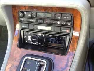

Here is a pic of my Parrot Asteroid 'Classic' installed, with aftermarket surround that suits the non-parallel shape of the gap. I like the low-key look, doesn't look out of place in an 18 year old car.
It had JVC 6" speakers installed with the Parrot 2 days ago, but I noticed the front passenger door 'buzzing' which really annoyed me.
I took it back to the installer who found the cone on the JVC was about 3mm bigger diameter than the Jaguar original speaker, and was hitting the door card. They tried spacers, but ended up going down to a set of four 5 1/4" JVCs - problem seems solved, in fact more bass! Go figure...
I am still contemplating a small powered subwoofer for a bit of extra low-end. Has anyone got any experiences? Ideally I'd like a slim one that could fit under the passenger front seat. Alpine do one, but it is probably too thick at 114mm to fit. I am not after crazy bass, just a bit more for normal listening and to hear it over the road noise - in NZ we have coarse chip sealed roads which are very noisy and overpower bass from car sound systems.
If you have put a subwoofer in the boot of an X300, has it worked for you? - the petrol tank is between the boot and the rear seat..
thanks, Al

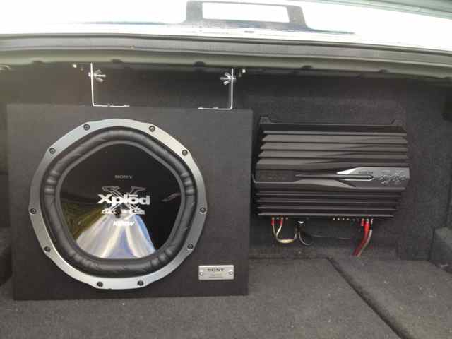

I am slowly working through a stereo upgrade in my 95 X300 Daimler
I have removed the tape deck, put in a Parrot Asteroid and 4 door speakers, 5 1/4" JVCs which sound good at rest, but NZ coarse-chip tarmac is louder than the bass, so I now have a Sony Subwoofer in the trunk powered by a Sony 600W amp.
It sounds good, but I have never had a sub before and didn't realise the upper limit is only 100Hz, so I feel there is a 'gap' between deep bass (sub) and what the door speakers can do.
I am pretty happy with the sound, I can listen to my Zep/Stones/Who etc, and the sub is only 24 hours old. I have been told it will take a couple of weeks to loosen up and be at its best.
I am keen to put in some 6x9s to fill in the bass above 100Hz, and the Sony amp can run them. I wonder which would be best? I am not that price-conscious, just want good quality.
The rear parcel shelf doesn't really lend itself to 6x9s - it has a roller blind for the rear window which gets in the way of big holes, and the petrol tank is only about 2 inches below so there isn't much depth. I wondered if there are good spacers available (I have seen plenty on the net but don't know what is best) and whether spacers are OK or give crappy sound. I could try to source a secondhand rear parcel shelf from a Jag X300 which I assume doesn't have the Daimler's blind, and swap them out to avoid destroying the original shelf.
Various internet reviews recommend various speakers. I see some USA-made DD's, also the R-spec Alpines,. JBLs win one review
Any advice or recommendations?
thanks, Al, in NZ

A quick little something i noticed. Your Sony amp will not run the 6x9's in stereo the way the should be ran.
Spacers are fine and dont hurt anything.
I hate to sound like a speaker snob, but here is what i would do personally:
-Upgrade the JVC speakers
-Upgrade the Sony sub
-Upgrade the Sony amp
-Get/make a ported box tuned to around 33hz
You could upgrade all of that on a reasonable budget, EASILY under $500
The equipment itself is whats hindering you sound quality, not the quanity/size of speakers.
And is the Parrot the deck you are using to drive all of the speakers?
