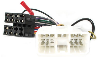

My OEM stereo tanked and I want to replace so I removed it and bought the wiring harness adapter from the UK that converts it to an ISO connector. Now I can't ind a stereo that has an ISO but only I guess what is the new standard a 16 pin. How do I figure this out and are the pin layouts universal across brands or do I need to match the brand to the config?
Its simple, match wire colors from the ISO harness to the colors on the aftermarket stereo harness.
ANY Aftermarket stereo will work, they all come with their own wire harness
(Make sure you double check the wires though, some manufactures change a color here and there but it is RARE)

If you need help, PM me with a pic of your harness and the radio you are interested in getting, i can also guide you in the correct direction of a quality radio. I can give you a full walk-through of how to install it, after your done, you will be able to install a radio into any vehicle

Thanks Jake21,
I have the adapter for the harness to get the ISO but now it seems I have to buy the adapter to the typical 16 pin from either Europe or Australia!! Are they not available in the US? I am looking at a Pioneer with Bluetooth hands free and the ability to turn the display green to match the dash. Any thoughts?
Thanks Jake21,
What 16 pin harness are you talking about? Do you have a picture of it?
Also, upload a picture of the ISO harness you have so i can take a look at it.
And good choice on the Pioneer, they are good decks, is there a specific model # your looking at?
Thanks Jake21,
Is this the harness you purchased?
Almost - the one I bought is a twenty pin but otherwise looks the same. Apparently the deck comes with the 16 pin plug and bare wires so that I can do the splice after the plug I bought and not cut the OEM wires. I bought a Pioneer DEX-H6500 BET as it got good reviews for Blutooth and iPhone connections.
Take a pic of all of your harnesses and i will show you what to connect to what
