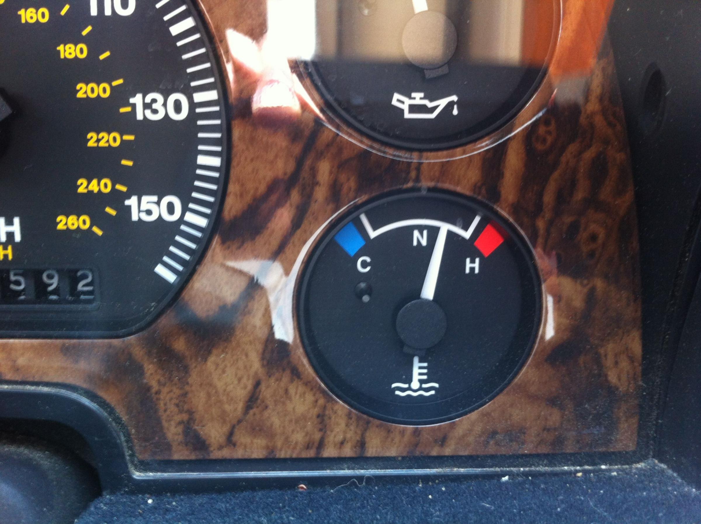

Yes perfectly normal, (but not necessarily optimal ) the fan is only controlled by the thermal switch in the radiator and is completely independent of the A/C.
It is designed to switch on at 96C and off at 91C. Because of it's location about 1/3 of the way from the top of the radiator, coolant temps exiting the thermostat are about 100-103C (~212-218F ) before the fan switches on, this will show as about halfway between N and H on the gauge, however this is still in the 'normal' range as far as Jaguar are concerned. This pic shows my gauge just before my fan comes on.
