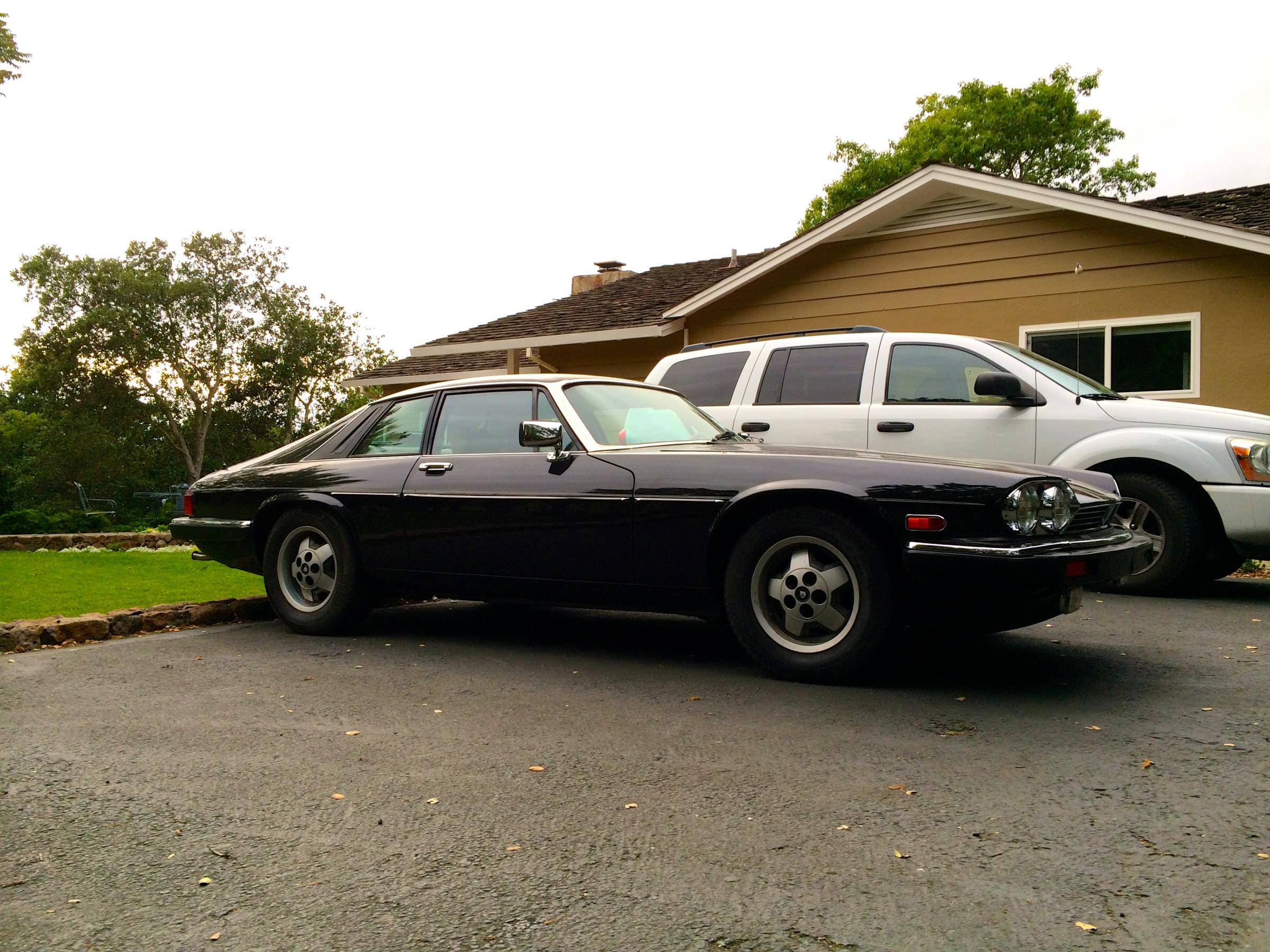

Here she is but despite how the picture looks the paint is very faded and I'm having her repainted (black) down to bare metal scheduled at the beginning of June (will post pics of course).
Speaking of "her" I still haven't thought of a name yet.. Any ideas?

Looks beautiful in the photo! How's the interior?
