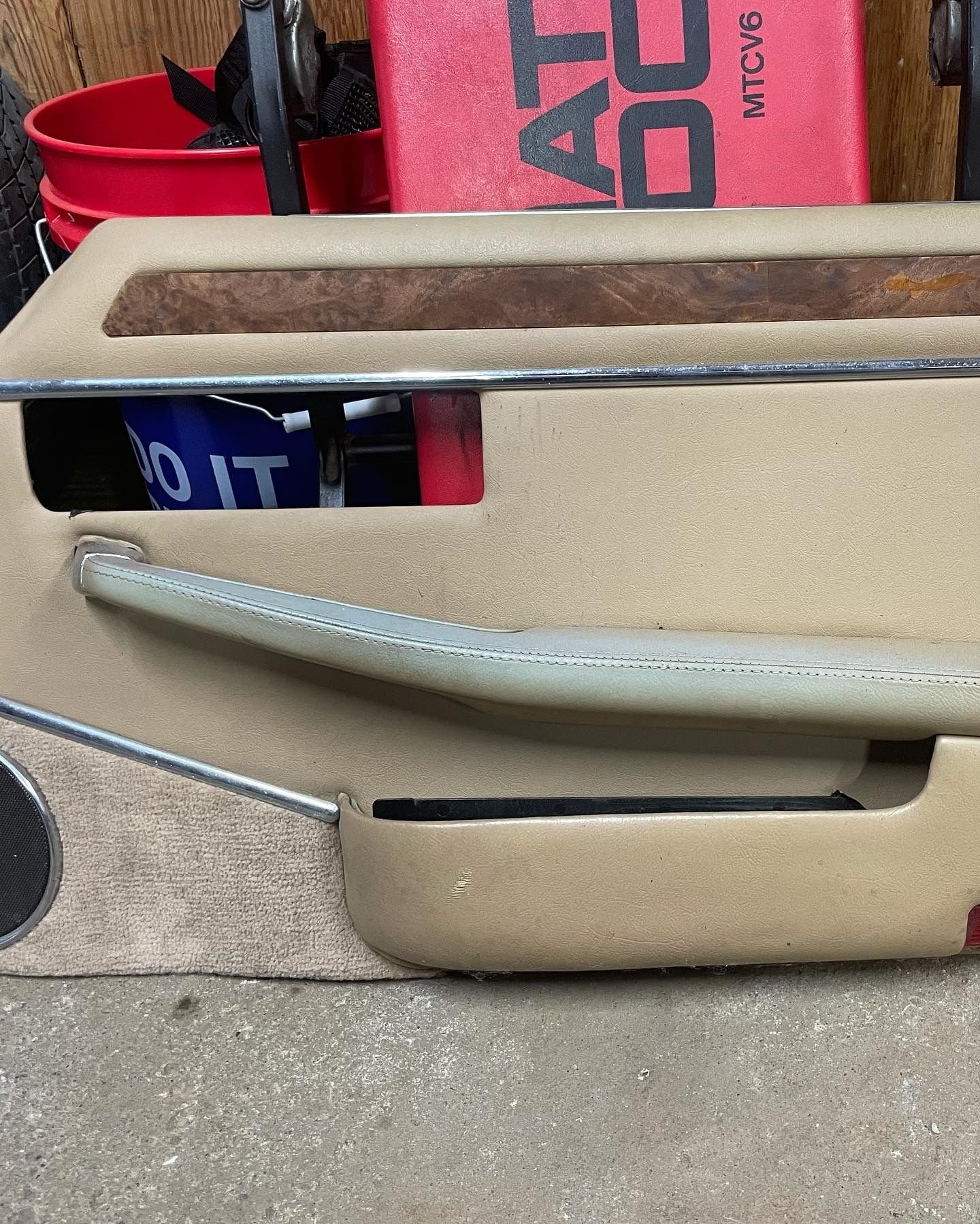

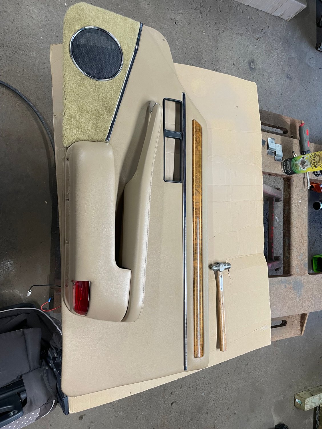

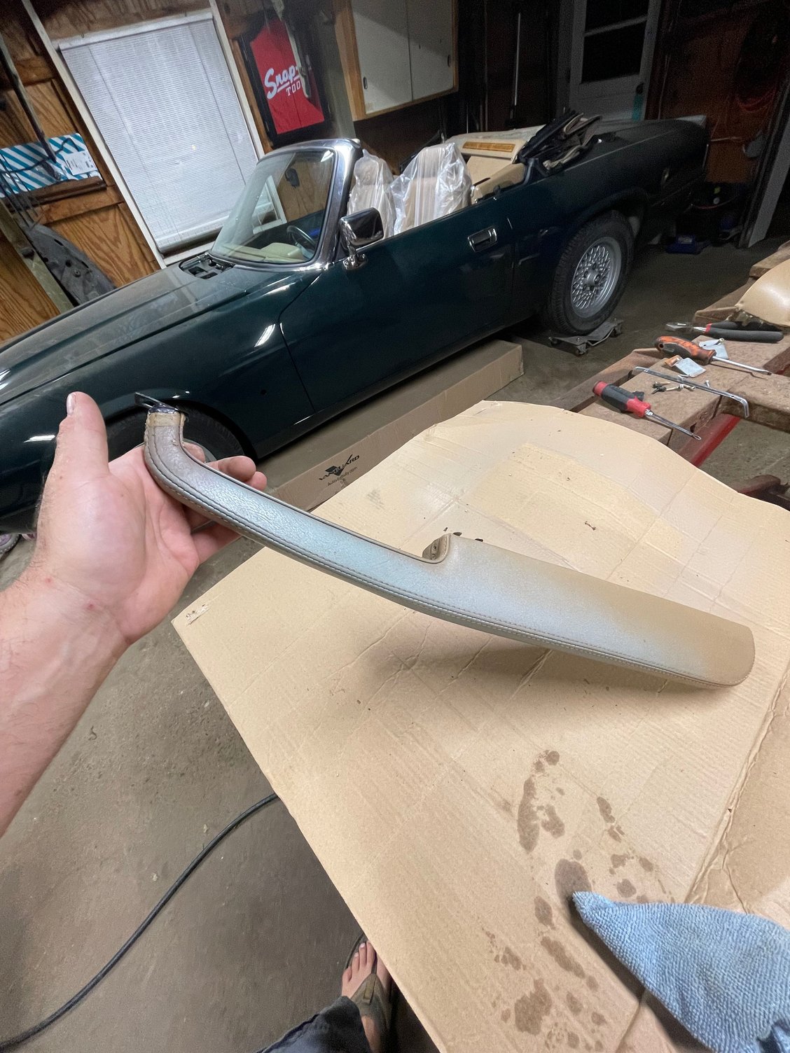

I used Classic Dye Products when I was repairing a very sun faded armrest and door card on my 1993. The color match was great.
