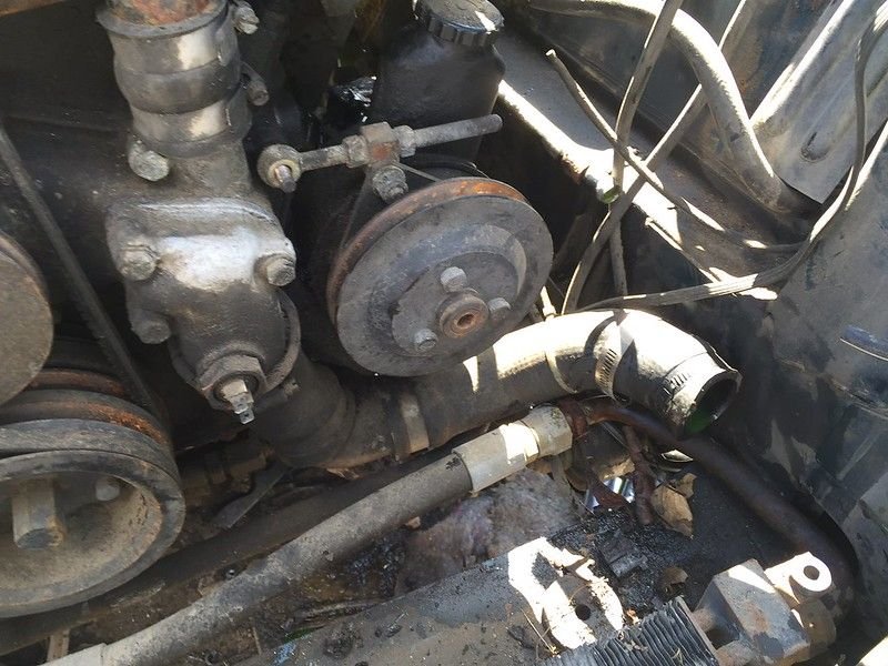

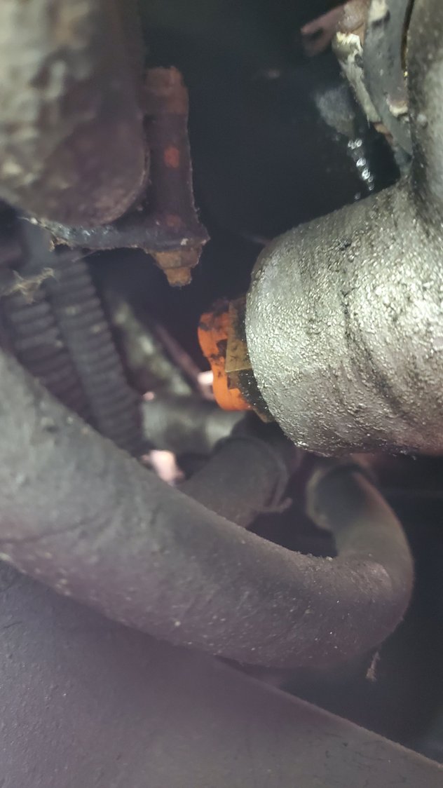

Not in the block like normal ones.
Bottom left hand side radiator hose. Orange piece is element. Into a metal T.

Standard on Canadian cars. Here is another photo of one in the lower rad hose.
XK engines have a boss on the side of the block to accept a screw in element, XJ40 and X300 sedans have the boss moulded right into the lower rad hose.
