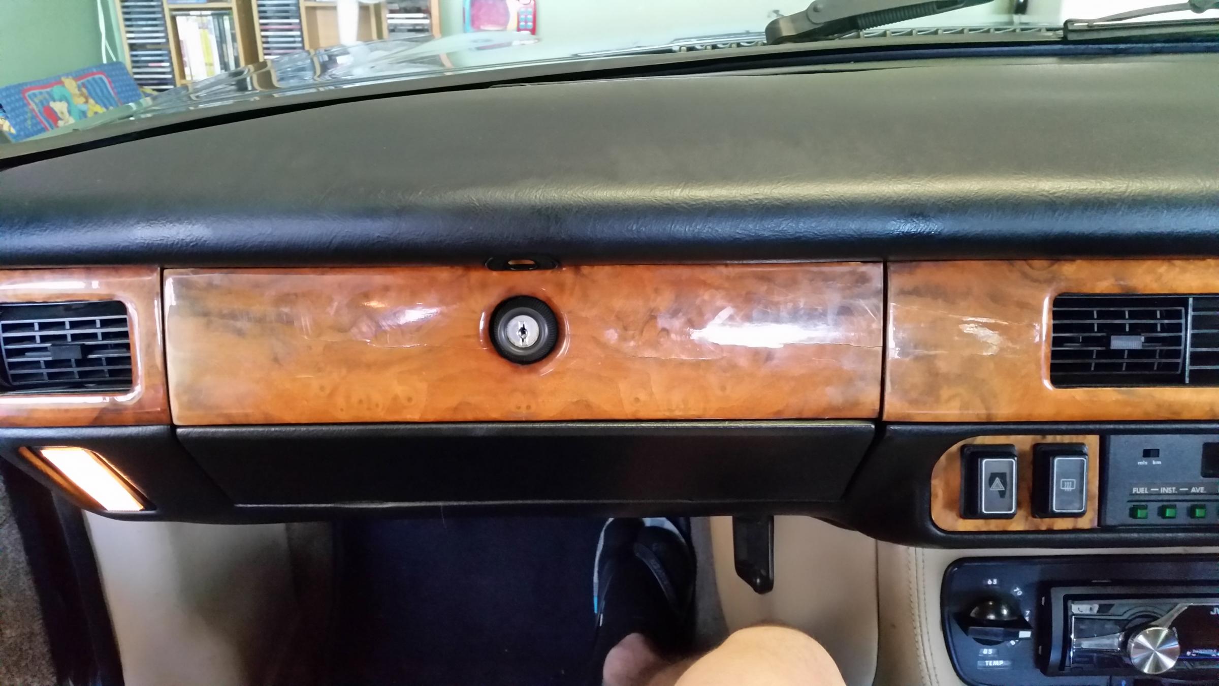

Also, thought I might post some interior pics of the Goose. Shes in pretty good shape save for a few things to be expected from a 29 year old car.
With cracked wood grain, Im guessing you'd have to tear it out and replace right? No other solution?
Any hints on cleaning the inside of yours and keeping her lookin chipper?
