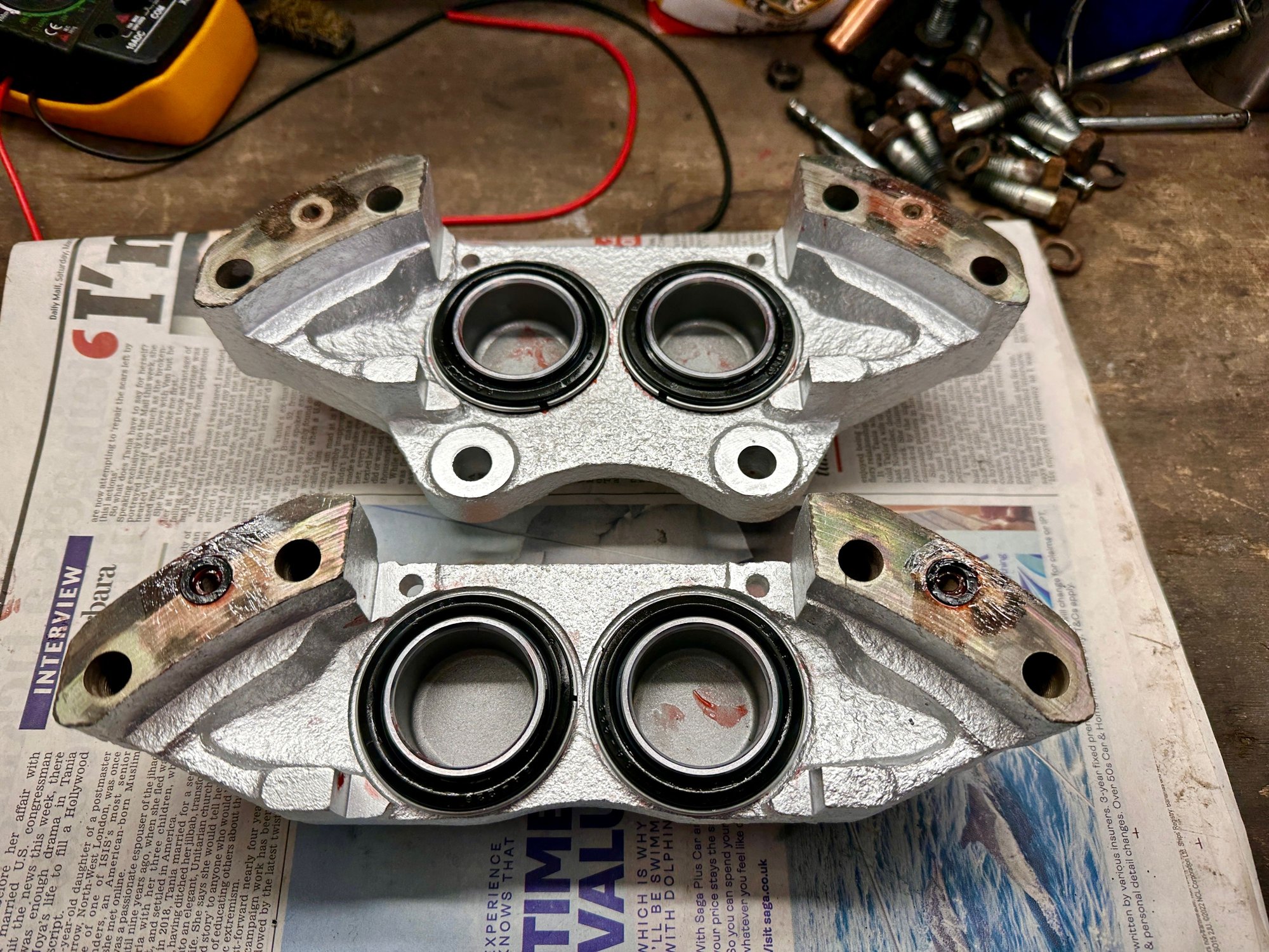

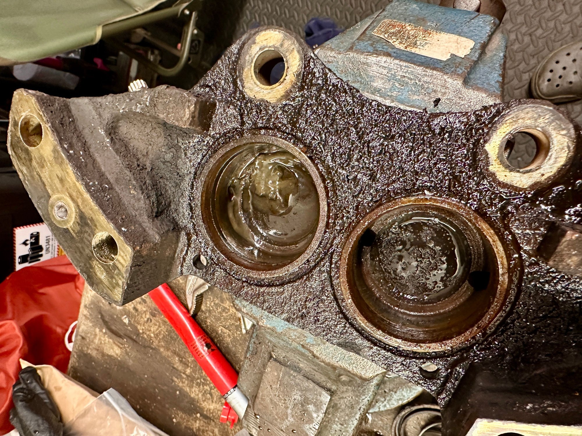

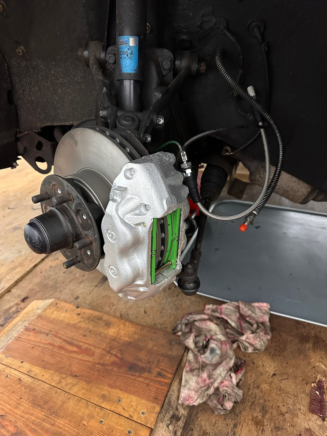

I have now rebuilt all my calliper's. Rears last years as one started leaking an involved job as you have to remove the rear cage for access. New disks at the same time. The fronts I rebuilt a few weeks ago again with new discs and stainless steel hoses. This is an easy job and very satisfying. Yes I could have put new calliper’s on the car but the old ones do recondition well being cast iron as long as the piston bores are ok and not pitted.

Lovely job, Robbo.
