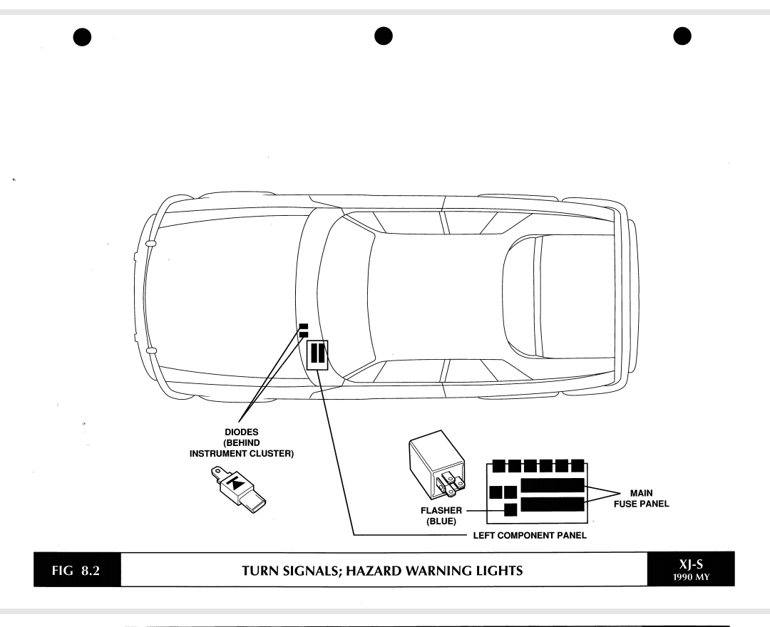

I'm just pulling up to work and am going to have to look a little more closely. This is for a 1990. I'm not sure how much change one can expect... My email is jayharris85@gmail.com - if you send me an email I'll try and send ya a copy of these electrical diagrams. Lol, on these cars, you'll need it!
