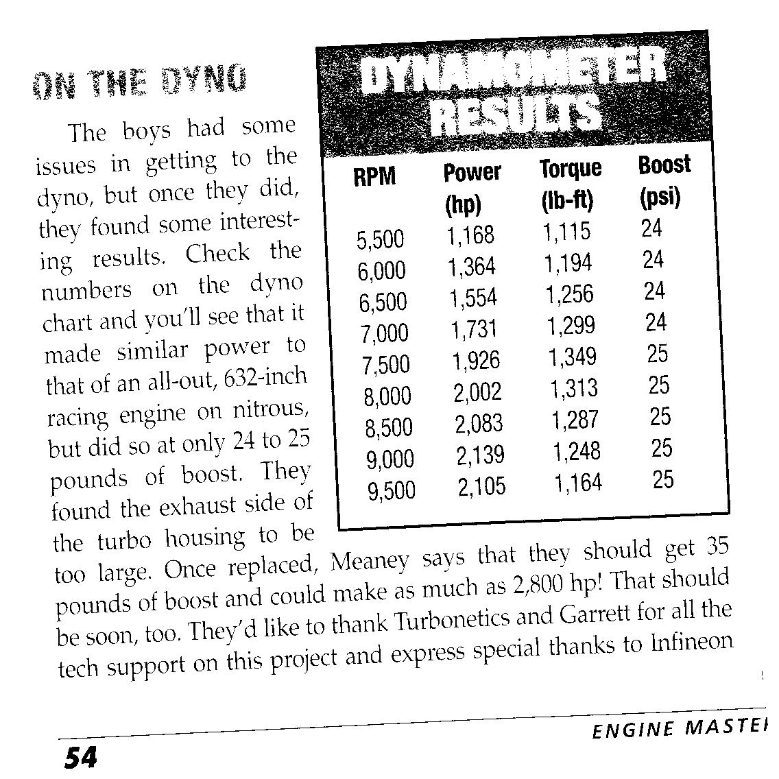

lookin back thru my old papers, found this interesting Dyno sheet,
likem or hatem, hard to beat a big block chevy, 5yrs ago.
course modded to the friggin hilt!
any opinions about HP and torque?

warrjon's Avatar
Posts: 4,638
Likes: 2,583
From: Vic Australia
Originally Posted by 88-xjsv12
the twin cam would have more low end torque (and possibly even vacum at an idle) so if it has low end torque thats purfect for what im looking for and possibly others look into that route. the heads are cheap so why not ?
heres the real question do they flow better? if they dont then there is no point i see in doing it
The twincam head would make less torque (and HP) low in the RPM band I have seen dyno graphs of the TWR twincam and it made great top end HP but lost below 4000rpm.
Ultimate flow for HP is not necessarily the best for a street motor.
I was reading an article by the guy who built Formula Ford engines for Ayrton Senna and Johnny Herbert. His heads did not flow as much as others but his engines produced lower lap times due to more torque lower in the RPM band. In testing they found Senna was 1 gear higher in the chicane on the test track. And the rest is history......
