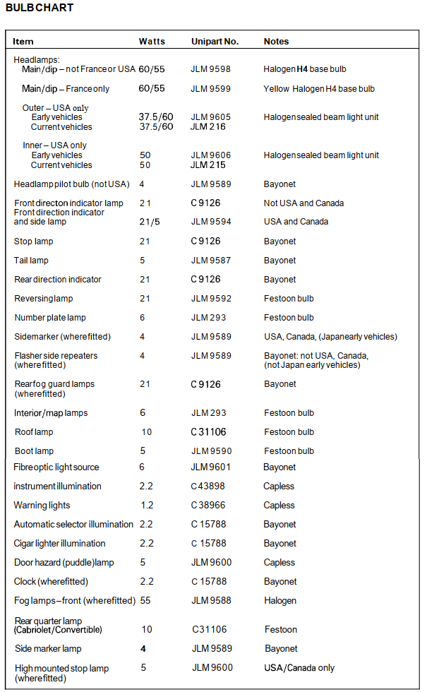

Cigar lighter identifies as C15788 Bayonet - which is a screw in type 2.2 W - pretty sure that an 'E10' profile is the same thing from any supplier you might want to compare profiles to this E10 2.2W
Various instruments are 'C43898' 2.2 capless - profile is W2.1

I changed all my interior bulbs, trunk, backup and license plate to leds but its been a while. I had my lighter in the garage because I put in a usb port charger not long ago. mine is a 1989 also. The lighter has a ba9s 1led bulb, 2 prong push and twist and I think the switches take ba7s 1led which just push in. Post a picture of your bulbs.
