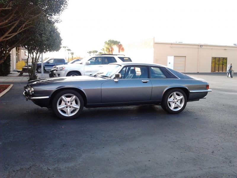

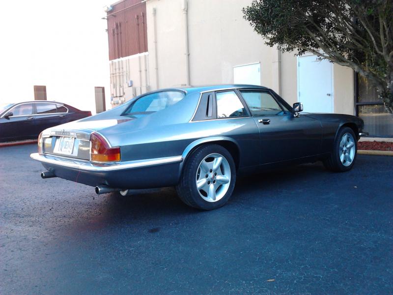

I removed the battering rams and came up with a thin chrome alternative.
These are two sets of blades, modified to fit, one set welded to the other. In the front, the fog lamps were moved to the hinge bracket to cover the bumper mounts.
In the rear, I removed the bumper shock mounts tubes and the reinforcement plate. I welded patch panels over the holes, then painted.
I installed a facelift grille and still need to install the front spoiler.

I like it, the overall view, and the wheels give it a good look.
what size wheels and who made them?

The wheels are 17" revolvers from a 1998 Jaguar XK8. The tires are 245/45-17 Yokohama's.
Doubling the blades was an easy way to get a good fitting bumper without a lot of modification. It also shaved 60lbs off the car.

Looks great to me, and a lot like what Jaguar originally intended according to an illustration I have around somewhere...

Here's the illustration. It was scanned in by another member of either this board or Jag-Lovers. Sorry that I don't recall the original source. The only difference is that in the illustration below there are two vertical supports present (and some sort of license plate bracket), which supports I think would greatly enhance the function of your bumper and prevent it from being bent upwards/downwards if impacted.
