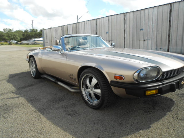

give you something to shoot for!
my 1978 XJS weighs in at 3375lbs!!
