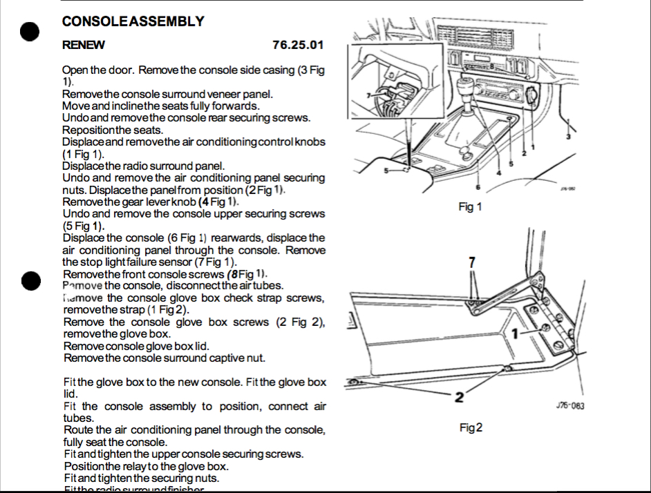

Hi all , I'm trying to remove the centre console on my 89 convertible . I have removed the ski slope and cubby box and the 4 screws under it. Now I'm stuck. Could anyone tell me where next in order to get it out please. I've done a search but couldn't find much. Many thanks for any assistance .

Maybe this will help you out.

Also there are screws on each side near the rear of console that you have to push the seats forward to access that people often miss. They are below the upholstered portion of the console.

Is there any chance of posting a clearer picture as its hard to read. Many thanks for your help

Hi Sonny , have you tried " clicking on the picture " ?
