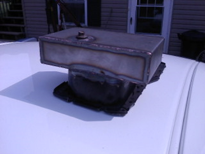

more crappy cell phone pics. got the oil pan back from this enormous industrial machine shop in my podunk town. the guys there are always busy working on huge projects and pipelines so they took about 8 weeks to finally get around to it, and they ended up not charging me a dime when it was all said and done. i wish i had better pics because they did an absolutely amazing job. they also welded little support tabs on my pickup screen.

Looks great! Can't wait to see how it fits.

so far, it fits the block amazing.
also i gained 0.5 quarts in oil capacity over the stock pan so im pretty excited about that as well.

Is there any baffling in there for oil control?
you only get so much for free. lol
no, theres no baffling. because these style pans are so much deeper than V12 pans, its typically a non issue. in fact ive never heard it mentioned as an issue.
this particular pan is even deeper than factory and holds more oil.

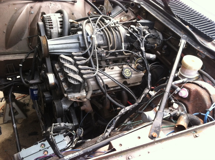

well some updates have occurred. The swap is pretty much done. major components left are i need a driveshaft. ive got to come up with a way to run the TV cable, i need to run some cooling hoses, and i need to wire up this monstrosity.
and ill be done.
other updates, ive gotten pretty heavy into the weight reduction on this car. back seats came out, a lot of insulation came out, wiper motors came out, headliner came out, stuff like that. so far im digging it.

another quick update just for Calvin. i got the wiring mostly sorted out. ordered a relay and fusebox set from ebay so i can run the injector fuses and junk.
relays for fan and fuel pump on the way.
trying to decide who to ship my ECU off to to have it retuned for the swap. factory tuning has a safety bypass to shut the engine down if the factory transmission gets unplugged or whatever. so that needs deleted.
im gonna have to run some actual piping to route the cooling system from the thermostat housing on the back of the engine to the front of the bay, which is inconvenient.

wiring harness is totally finished........ my God, what an overwhelming amount of work.
