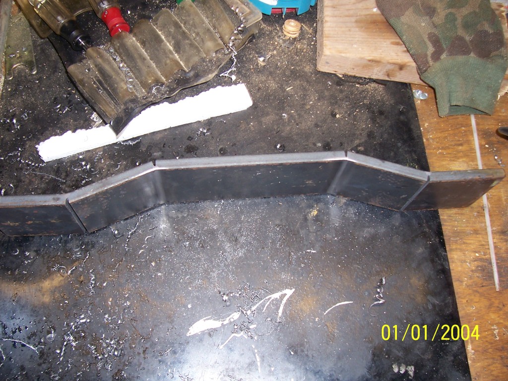

Got started making the motor mounts.
Old Sep 21, 2012 | 05:37 PM

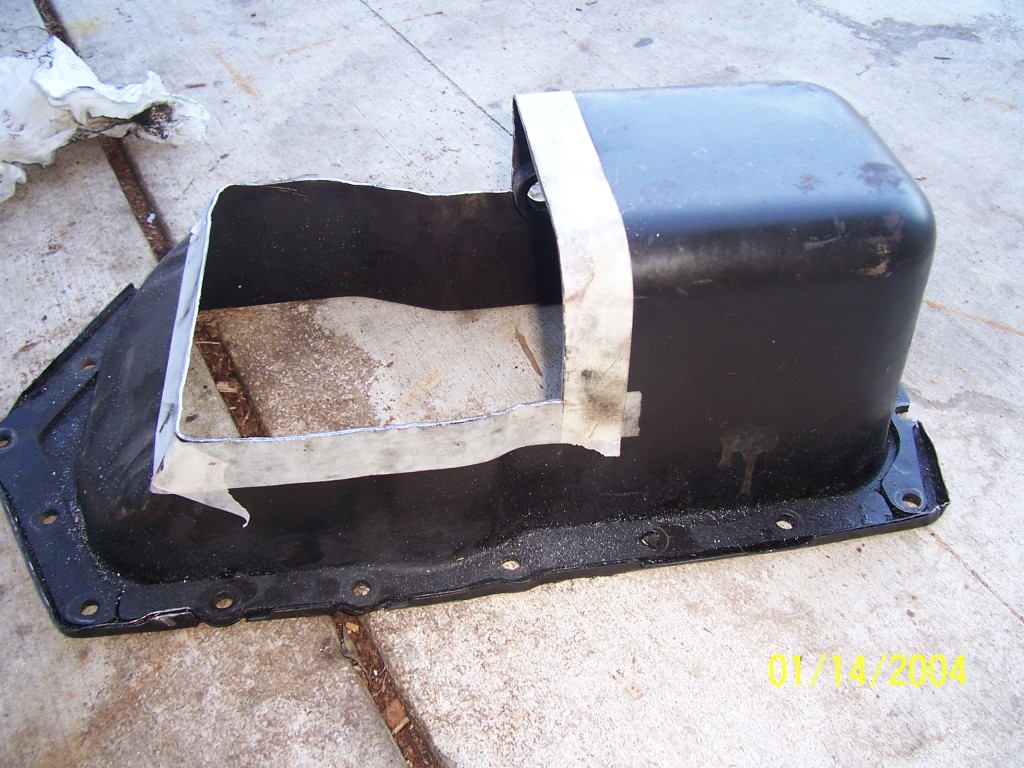

Got the transmission crossover fabbed up. cut, bent, and then rewelded.
also bent some 22gauge sheet metal to patch the oil pan with. anyone think thats too thin?

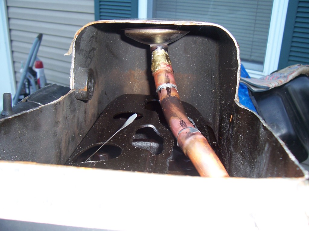

well after 19289239842 trips to the hardware store, 2 benders from a going out of business sale, and some crazy copper pipe, i finally managed to hobble together the pieces to make my oil pickup. brazed on both ends and soldered in the middle.
so pumped. just need to get the oil pan welded back together.
anyone know of a cheap supplier for 20g sheetmetal? also i still need to make a drain plug in the pan.
Old Nov 8, 2012 | 06:07 PM
  #37
FastKat's Avatar
Joined: Jun 2012
Posts: 382
Likes: 52
From: Northern Virginia
Are you sure that the pickup will not suction itself to the bottom of the pan? I have never made a pickup before, so I don't know how much space you need to leave between the pickup and pan, etc.
Are you going to put any baffles in the pan? Where there any there in the first place?
Old Nov 8, 2012 | 06:46 PM
  #38
M90power's Avatar
Joined: Oct 2011
Posts: 1,738
Likes: 70
From: WV
i was sort of afraid of the same thing. i was looking at the old pan and there was very little clearance between the pan and the screen. i was less worried about it suctioning itself to the bottom, and more worried about it creating a bubble and running dry. since the copper is a little more flexible than stock, i left the screen at a bit of an angle just incase it would decide to make out with the oil pan.
there were no baffles in it to begine with. this pan isnt gonna have much more than about 3qt capacity. stock is 4.5qt
Old Nov 8, 2012 | 07:42 PM
  #39
FastKat's Avatar
Joined: Jun 2012
Posts: 382
Likes: 52
Maybe you could put in a support beam to make sure that it does not move around and break. It doesn't take much to give it a lot of support. My engine has a piece of sheet metal that goes between the pickup and the windage tray to stabilize and strengthen the pickup itself.
