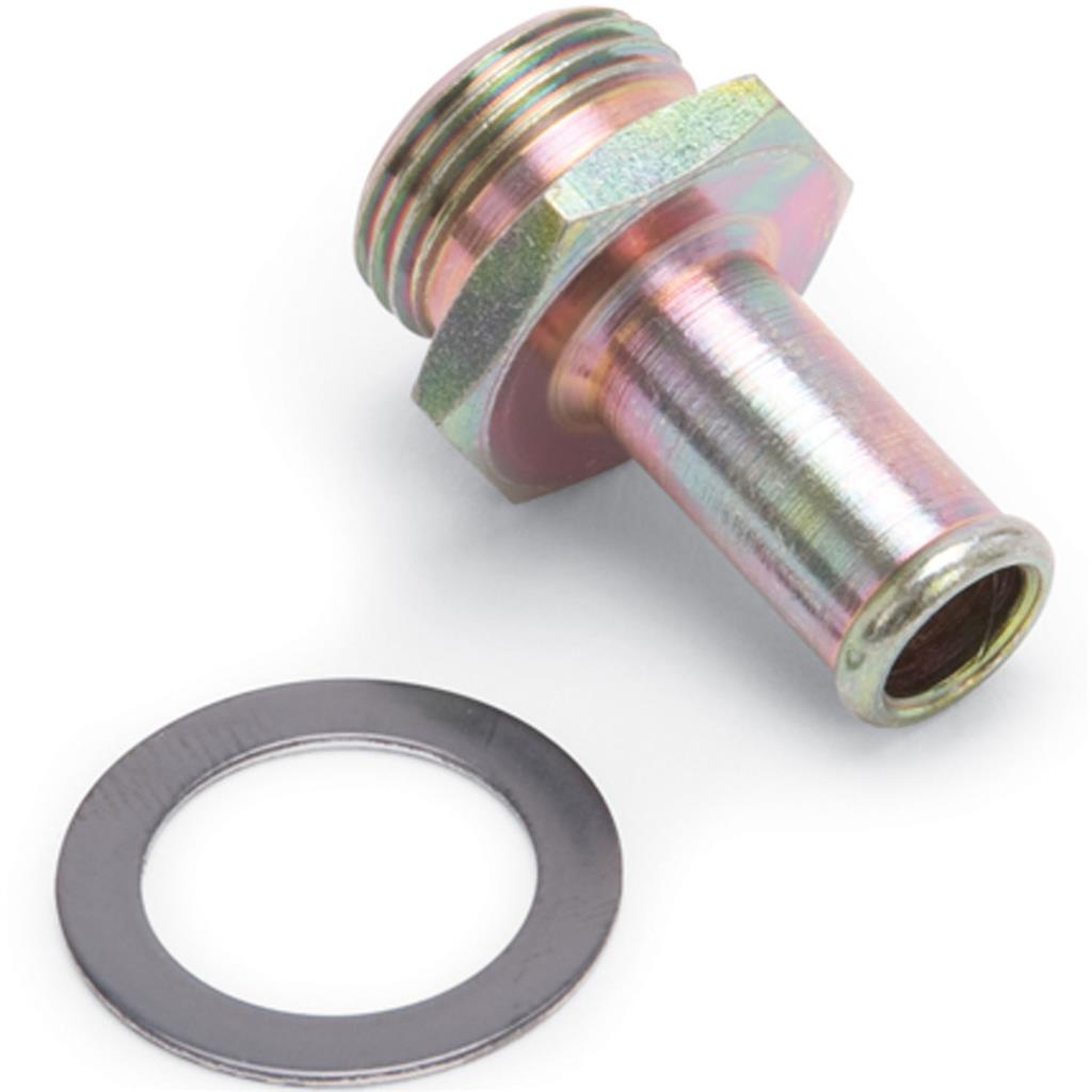

I don't think anyone is saying it's a big deal. But, the fuel rails in question are the multi-barb type with the hose being pressed-on with an end cap. That's the intention. And, clamping a hose over a barbed fitting can damage the hose. I'm not saying it *will* damage the hose. But that it can. Therefore, 'not good practice'.
Not to go too far off into the weeds but there are barbed nipples and then there are barbed nipples. Some multi-barb nipples have very sharp and/or deep barbs; others not so much.
On hose nipples deigned for clamping the single barb typically isn't much of a 'barb' at all. Not very sharp; often somewhat rounded. The idea is that the clamp goes behind the barb on the smooth portion of the nipple. I've attached a couple of pics.

I've rarely seen the sharp multi serrated barb used in high pressure applications or fuel line and are usually used in plumbing to be honest. But the smooth single lip/barb nipples almost always have a clamp of some kind in pressure applications (my XJR6 has OEM worm gear clamps on similar lipped barbs for coolant lines), and in high pressure fuel applications use specific fuel pressure line clamps not worm gear clamps.
So if your fuel fittings are smooth barbs with the single rounded lip, it is normal to use clamps, especially fuel line clamps.

why didn't Jaguar use clamps in the first place? I'm tempted to remove one hose just to confirm what the situation under there is....
As Jaguar didn't use clamps on the hoses it's an almost sure bet you'll find barbed nipples, as the barbs are what hold the hose onto the nipple.
If they were smooth nipples with the rounded lip then clamps would've been require to hold the hose.
