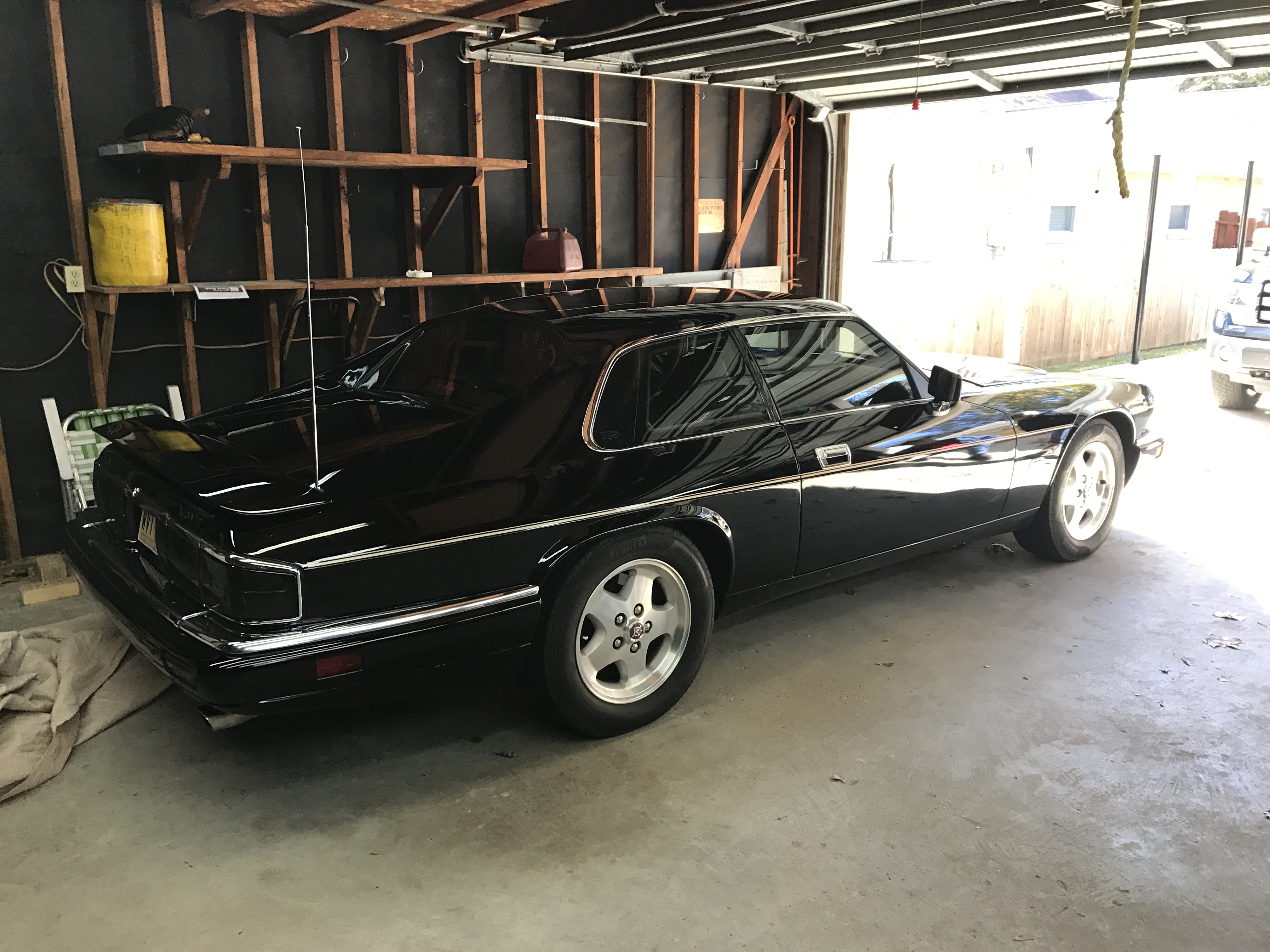

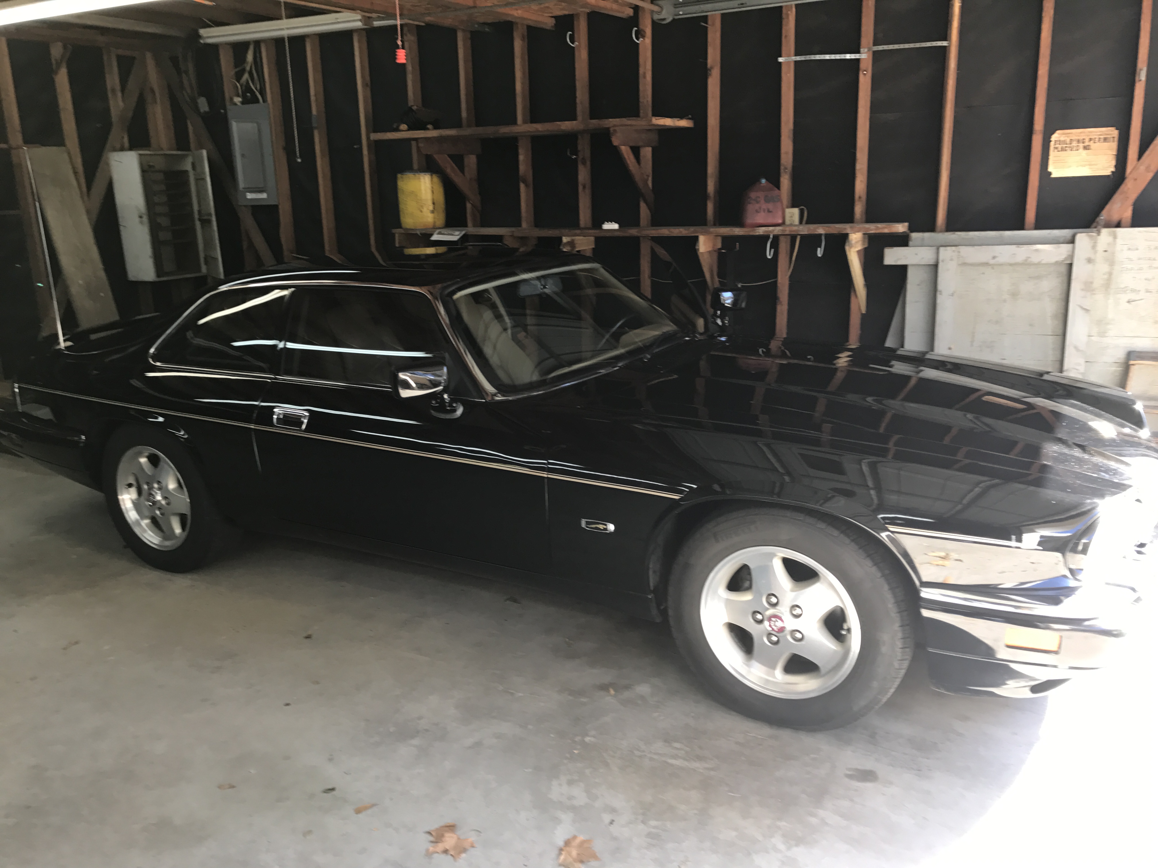

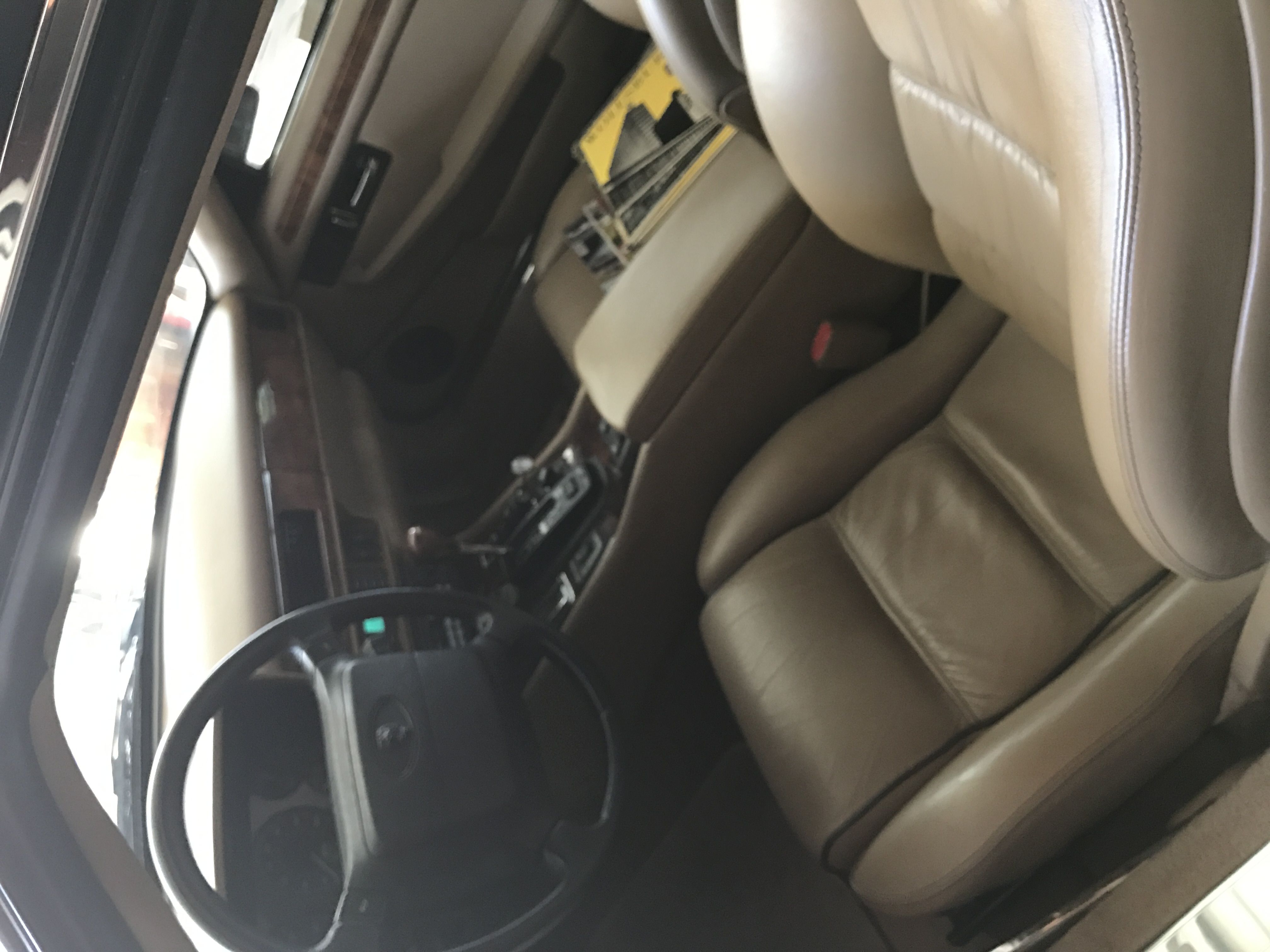

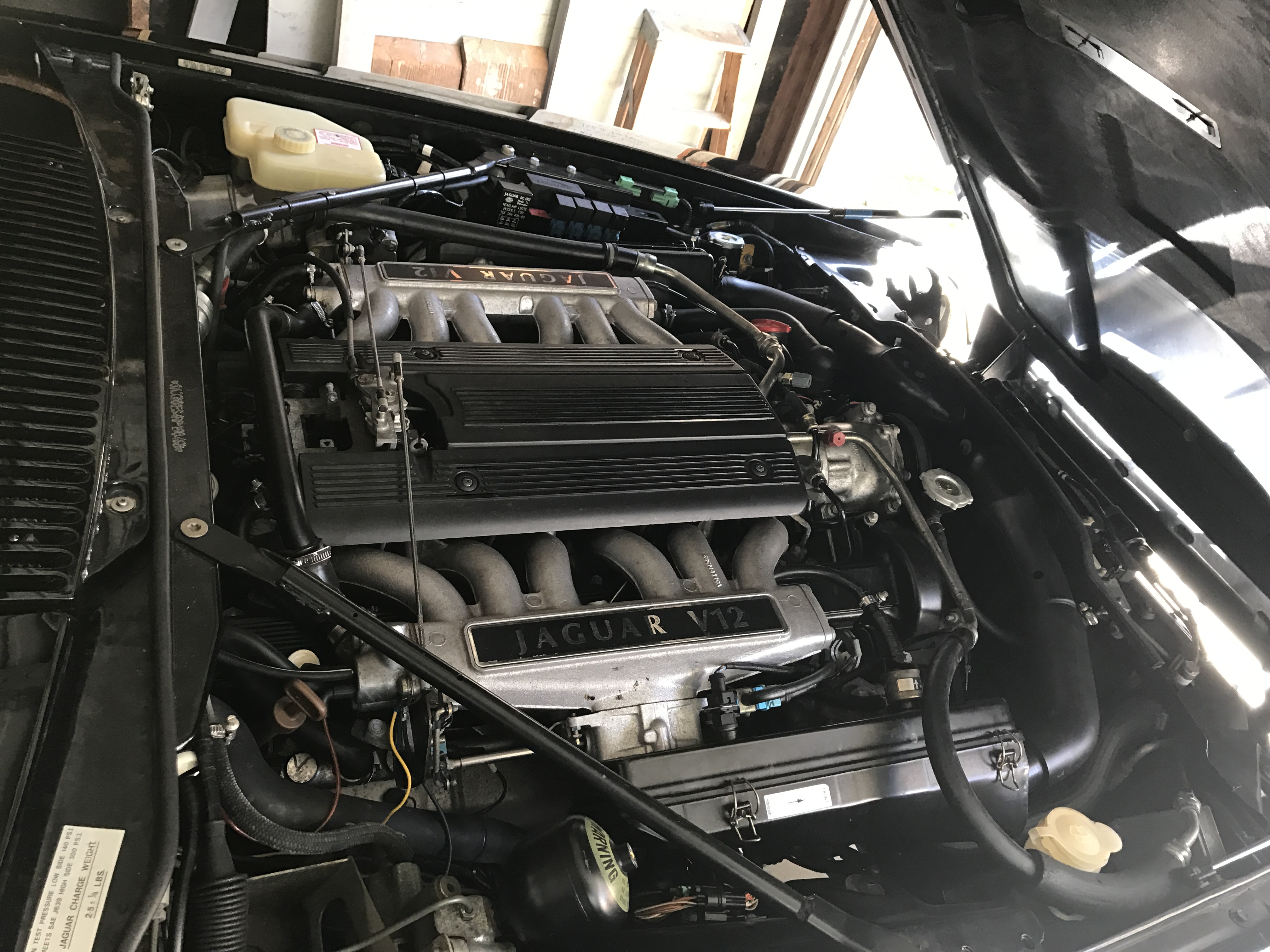

I'm considering a 1994 XJS V12 coupe with 57,000 original miles. It will not be a daily driver. The car is in almost flawless condition and looks like new. The only thing I noticed is the ABS light and brake light came on when I started the car and I was told the ac button or switch did not work. One of my good friends knew the owner who recently passed away. He said it was maintained very well. Looking for any suggestions of things to look for that I may be missing, what costs I can expect to maintain the car as I was worked the V12 is expensive to maintain, what money should I consider paying for the car. Any comments would be greatly appreciated.

Desirable model, looks sharp !
Make sure the cooling system is up to snuff. V12s will tolerate just about any abuse except overheating.
Service records proving regular servicing...full servicing, not just oil changes...are always a plus. Sometimes low mileage cars haven't really rec'd proper servicing "...because they hardly get driven....".
Even though it looks great carefully inspect it for rust, just to be sure
Not sure about price. Facelift V12 coupes are a bit rare and don't change hands too often
Others will chime in

Its not the ABS Light being on that is the problem, that is supposed to happen when you turn on the Ignition but when the Car has started, the
ABS light and Brake light should be going off.
When you Turn on the Ignition, can you hear the ABS Pump Priming and if so does that cut out after about 30 Seconds.
Then does the ABS and Brake Light both go off.
That seems to be the only Gremlin at the moment but also a Massive Bargaining Chip to the tune of $1,000 on the asking price what ever that is.
It could be an easy fix or maybe not
It could be something as Simple as a fuse! and if it is then I would keep that to yourself.
The Fuse should be under the knee pad on the Passenger Side.
There are 2 X 30 Amp Fuses which are Separate from the others and should also be clearly marked.
One is for the ABS (That's the one it might be, either blown or dirty)
The other is for the ABS Brake Pump.
Otherwise what's not to love!
Price wise $7,000 at least that's what I might be willing to pay with that possible fault.

I'd say take it for a decent test drive to make sure the temp's fine, check for rust, and then if both are fine, get it. Depending on price, of course. But that looks gorgeous in black. I'd have loved a 6.0 l, but they are so rare....

So I looked at the XJS again today. The ABS light did go off after a minute and everything else was perfect except the A/c (climate control system) was not working at all. They had got a qutoe of $3,000 to fix and the best I could get them to do on the price was $9,000 and still having to fix the a/c would push my total cost to around $12,000. I had really wanted to be around $7,000 with a max of $9000 with all known problems fixed. Initially I was not really looking for a car but ran across this one and told my wife If I could get it at a good price I would buy it just because it was such a beautiful car in just excellent condition.
Had I been actually looking for a XJS v12 coupe to buy I would have bought it because I don't think I could have found a nicer car out there. So long story short I passed on the car�� Thanks again to all who have posted comments I really appreciate you help!!!

I think you have been very sensible. The aircon could be just engine bay stuff; but it could equally be the in-car unit, which depending upon the fault, could be a dashboard-out job to fix. This is the worst job to do on an XJS by far, and quite complex with a decent chance of other stuff (like an instrument or two) not working when it all goes back in.
If you really wanted an XJS and could do it all yourself, great car. But bearing in mind what I hear about USA prices for the cars, $12000 with duff aircon is too much.
