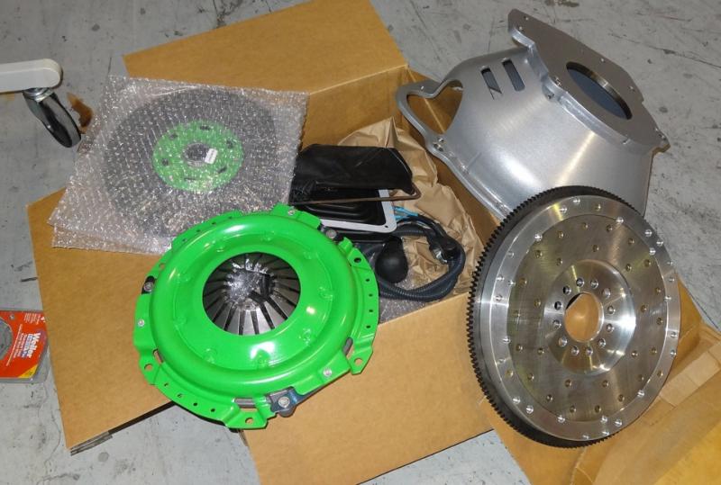

All seems high quality, no a single "made in china" found.
Attached Thumbnails Convert V12 to Manual Transmission-e2e25c8s-960.jpg   Convert V12 to Manual Transmission-eae25c8s-960.jpg   Convert V12 to Manual Transmission-71e25c8s-960.jpg   Convert V12 to Manual Transmission-99e25c8s-960.jpg   Convert V12 to Manual Transmission-f9e25c8s-960.jpg
Convert V12 to Manual Transmission-7de25c8s-960.jpg   Convert V12 to Manual Transmission-fbe25c8s-960.jpg

Excuse my ignorance, but can you fill me in with the back story on this kit pictured along with prices, etc???
Have a look at The Driven Man - Jaguar, Mopar, Ford, GM, Other British Brands - Specialty Performance Parts & Accessories
The hydraulic throw out bearing looks like an American Powertrain unit & I'm guessing by the colour, that the clutch pressure plate & disc are too.
I hope you will continue posting to this thread throughout the installation.

Clutch is unmarked, but on the bright side I found no "LUK" on it either. Chances are it will last. Everything is very sexy looking, plus entire kit is only 201 LB, so I am guessing one average size bloke is gonna be evicted from my car, as the result of this swap.
