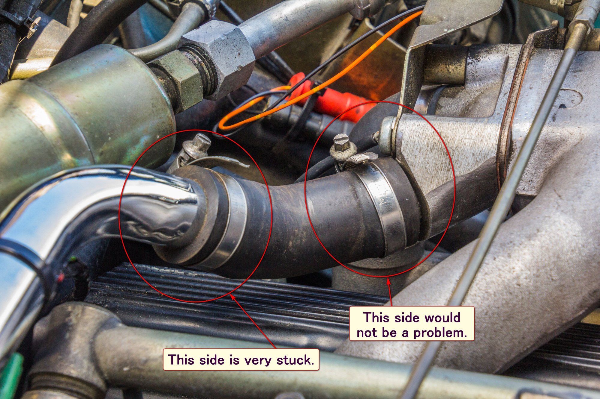

Well, I checked the hoses around the heater valve, and they're all nice and soft and flexible. I think they can stay where they are for the time being. I also experimented with removing the balance pipe, and discovered two things.
1. It's a lot easier to remove from the manifold end of the hose.
2. I need a new starboard (RH) connector hose. Not only is it much, much harder than the port (LH) one (which I can squeeze), there is a split in it. This, I assume, is not ideal.... (I am trying to track down the part number in JCP, but boy, they are hiding the balance pipe well....)
The other hose isn't trying to look like it's wearing a Victorian corset.
And for reference, here's the clearest shot I could get of the water valve hoses, showing them on either side. They seem fine. Soft, pliable. Good for a few more years yet. (I note that the valve itself says "Assembled in Mexico"...)
(Ah, here we go at last: Balance Pipe Hose EAC2654)
Correct, it's not good. The reason is there are two ways to determine the amount of air coming into the engine: The current way cars do it is with a mass airflow meter, to determine how much air comes in and thus how much fuel to add to achieve the target air-fuel ratio. Not that's mass of air, not volume.
Before mass air flow meters were invented, the way to do it was by calculation. The ECU needs to know the temperature, the vacuum level in the engine, atmospheric pressure, and the engines volumetric effeciency across the entire rev and load ranges, and then it is possible calculate the mass of air going to the engine. The vacuum level corresponds to the engines load, so lower vacuum levels equal higher load, and more fuel is added. The split lets extra air in and reduces the vacuum level, so it will run rich compared to what you want, and probably have a high idle speed too, since you now have uncontrolled air coming into the engine.
It's been a long time, but I think I used part of a radiator hose from a early 90's Mazda as replacement pieces for those hoses. I just wandered the junkyard until I found a radiator hose the right diameter and approximate bend I needed then cut it out.

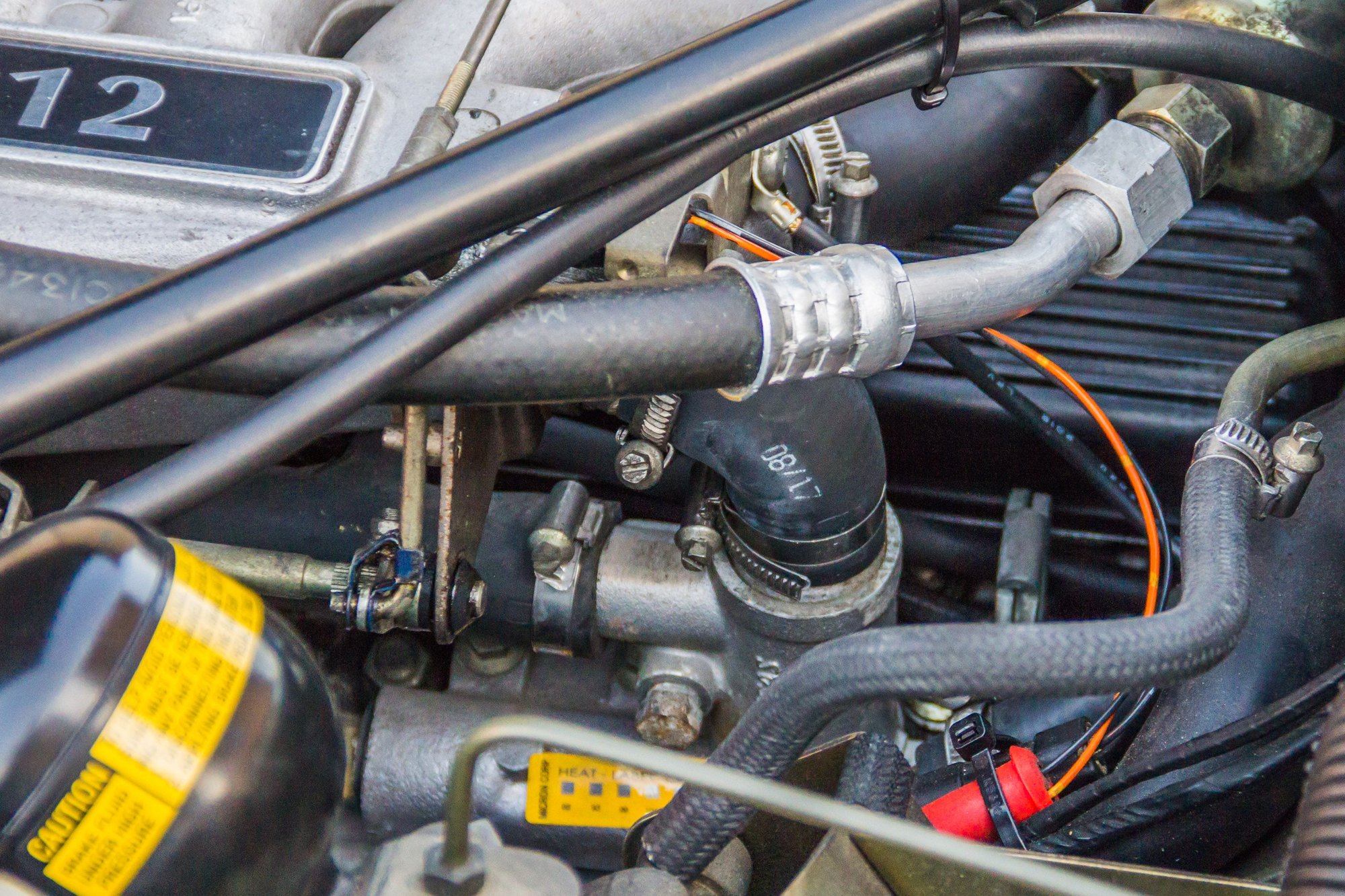

On checking, I'm not so sure the AAV hose needs replacing. It feels supple and new, no sign of issues, and there's "08/17" stamped on it, which MIGHT be the date. And, come to think of it, it would have had to be removed to take off the manifold, which has been done at least twice in the last couple of years. Here's a photo I took just now:
AAV and hose. Hose nice and pliant. You can also see an extra earth leading from the manifold to the bulkhead that was added last year.
