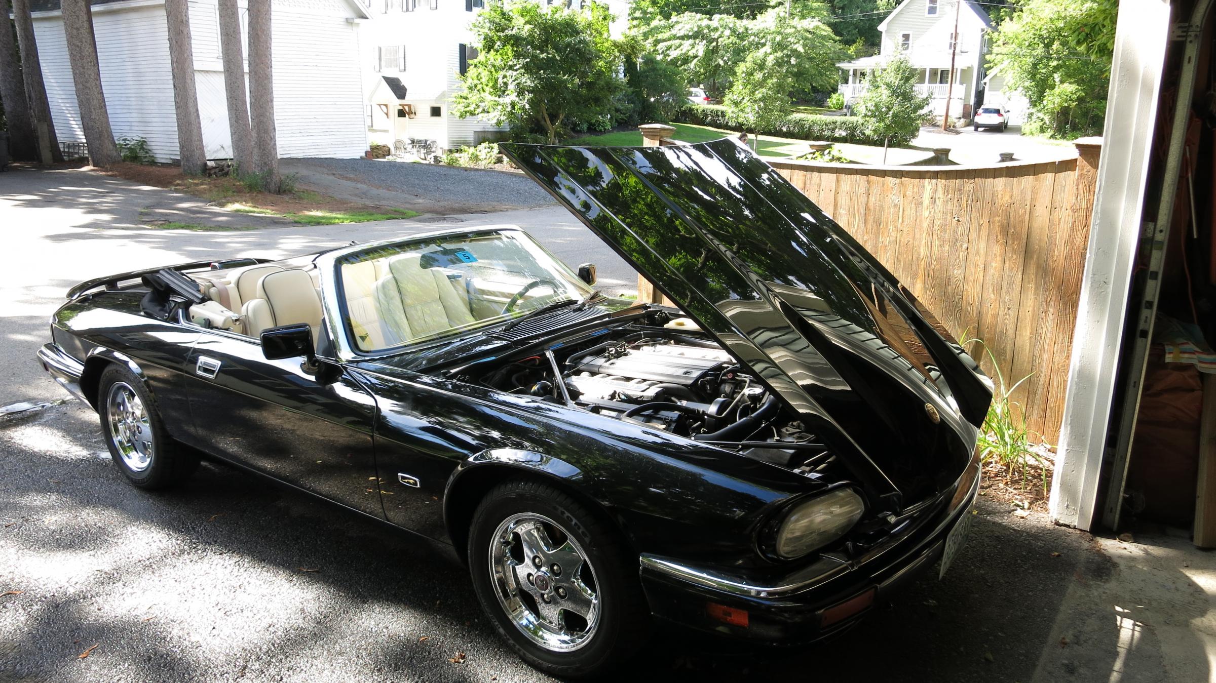

couple days ago 100F ambient, came back from a 3/4hr cruise, checked temps , coolant 185F at shutdown, air 175F at shut down.
waited 3-5minutes, opened hood,engine off, coolant had risen to 196F, air at 180F hood open.
here is where it gets interesting, using a infrared hand held gun , temps were very close to my in car readings, BUT the top of the cam cover measured 210F, must be from the oil splash inside cover!
