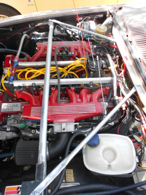

i changed the factory system,1978 XJS V12, to what i think is much better.
one problem was air gets trapped in the system at different places, so air bubbles rise and i added this high mounted coolant expansion tank,OLD Ford idea 1955, tank collects any air that is moving around in the system, and it stays above any liquid ,that way only liquid gets back to engine!
so far 21yrs no heating problems, in Texas 100F temps! DIGITAL temp gage reads 180/185 F all the time , but after shutdown goes above 195/200F ,heat soak up from the oil in sump, oil runs around 215/220F gage .
and i use two electric fans, also removed the radiator transmission lines and run a front remote oil cooler.
works for me , i dont know about anyone else!

My v12 has consistently overheated the worst from the T-stats, but I have also had a problem with the fan clutch, water pump, and electric fan. Never had issues with too much air in the system or hoses getting clogged.
I replaced my aux electric fan with one online for $30 with some minor cutting to the shroud. With a bad temp switch, this fan has been wired to come on with ignition and stay on (also florida) for the last 4 years and it has been fine.
Don't dick about wondering which tstat to get, just order the proper Jaguar part.
