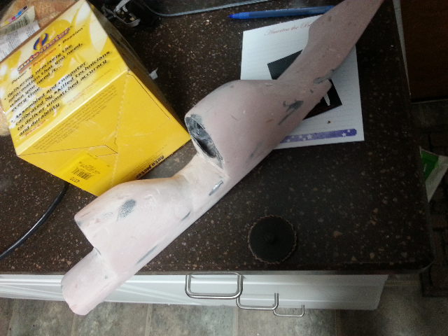

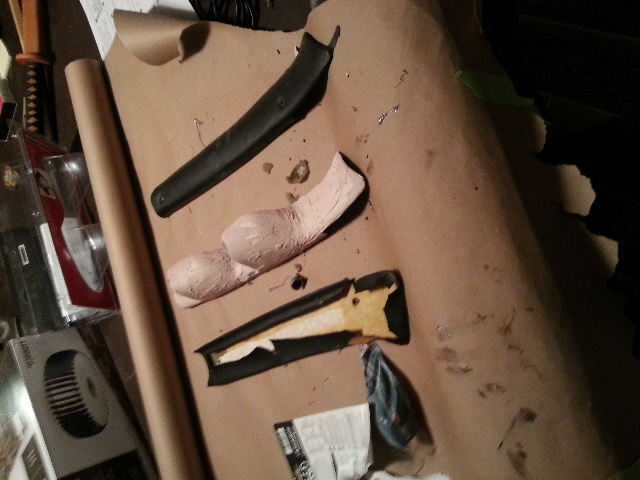

Just thought I would.share my custom a pillar project I've been working on the last couple days.
I started with an extra stock a pillar and then cut the pods off a cheap autozone universal piece, and jb welded.them to the stock (after removing the vinyl) and then I used body filler to smooth it all out and I'm pretty pleased so far.
