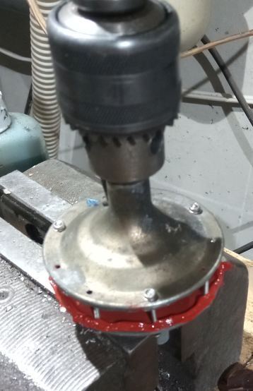

Decided to repair vacuum capsule
Old Feb 1, 2024 | 02:58 PM
dmitrev's Avatar
Joined: Jan 2024
Posts: 36
Likes: 12
From: Sofia, Bulgaria
Default Decided to repair vacuum capsule
Capsule didn't working, but I didn't expect so low grade materials inside. Capsule drilled before to open, to have possibility to assemble with bolts, after change of the membrane.
Selected silicone rubber for membrane, working from -60 to +250 degrees Celsius, NBR was -20 to +80 Celsius. I hope, lower resistance to oil is not a problem - will see.

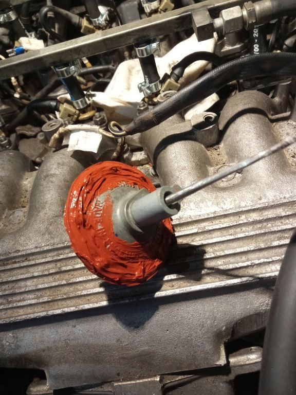

Default finished
and result:
A bit ugly, but working Tomorrow will replace "idiot oil switch" and fire the Big Cat again. Spark plugs changed this evening - very strange, there was gap more than 1.5 mm. I think that in the US car repair should be OK, not like in Bulgaria - anyone can do (can lie about) anything. Curious how this engine even starts.
