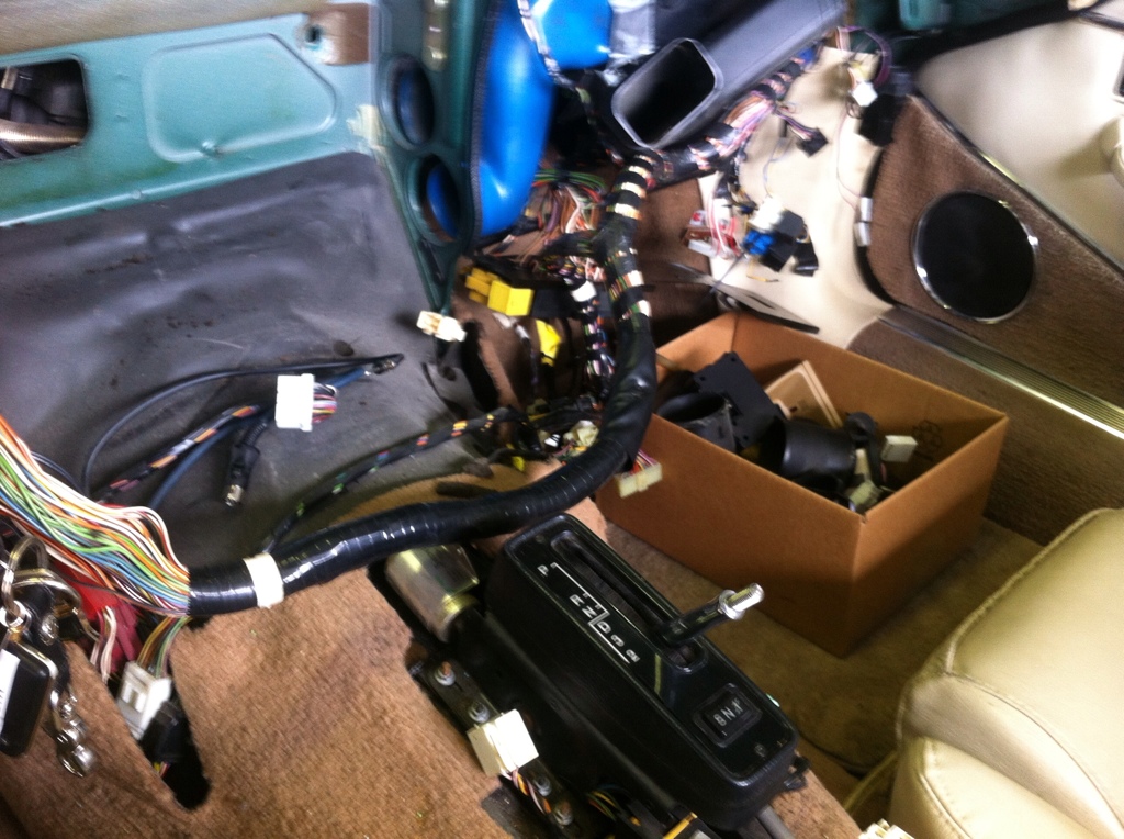

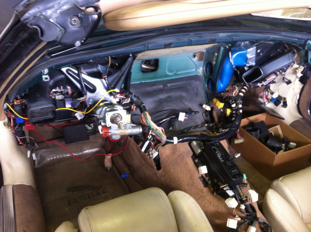

One thing to watch out with A/C on XJS's is the evaporator. If that is leaking, the whole car has to be taken apart. And it's not cheap.
This is my 95 during evaporator replacement:
Just make sure it isn't the evaporator, and if it is, negotiate the price down accordingly.

Wow, that looks like an impressive job. Thanks. I will demand a guarantee on the a/c . If they don't give one i will leave the car where it is.
