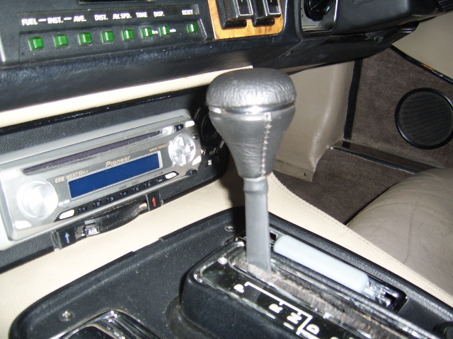

As in the picture my 85 is D --> 2 -->1

Also I like how you changed the gear stick to the round type handle as opposed to the t-bar handle. Did you do this mod? Much more sporter I think.

The gear knob was a no brainer years ago. I was bored, had a spare S2 gearlever in the junk box, and an XJ40 knob. So cut the lever, welded a UNC bolt to it, slid some heatshrink over my "impeccable" welding, and screwed the knob back on.
Fitting the S2 lever to the TH400 gate was NOT simple. 2 bottles of JD later, I simply pulled the "gate pin" out of the lever, and slid the lever onto the pivot pin. Now it goes from P all the way to 1, without that DUMB left/right/left nonsense. The detent INSIDE the transmission is more than sufficient to let you know where you are. It is really good to use, but I am a simple person, contrary to opinion.

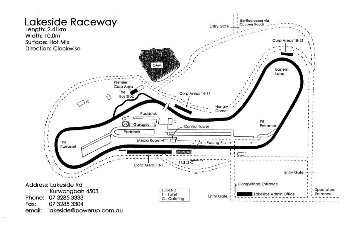

I was holding it in second flat to the floor through all but one corner on the track and keeping it flat until it hit about 5200 rpm before shifting to 3rd. No need for a rev limiter, they let you when you are hurting them.
Always pushed all my vehicles to redline at times and only ever broken one engine...snapped a crankshaft once.
Eastern Loop is the only corner I had to back off on as the rear end was starting to drift when it got a bit light going over the hill top.
