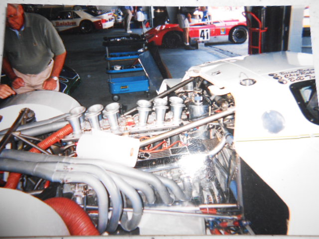

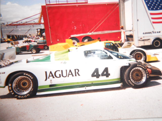

this an old pic 1985 about, car always sounded great , BUT! V12 engines always sound great, like my 1937 Lincoln V12 coupe.
i been around V12s for awhile!
