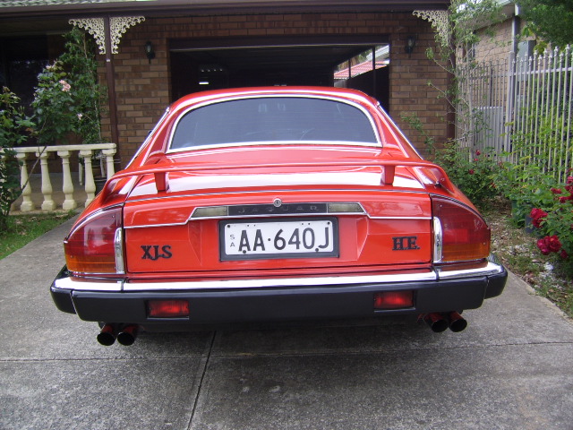

I looked at this on mine back in 1995, and lack of room under there for "normal" access, had me thinking seriously about it.
I eventually went with new front mufflers of a "thru flow" style, and 2" pipes hand made to go thru the cradle (easier than most will have you believe), and "Hotdog" resonators at the rear, with a fancy twin pipe tip on each, just coz I could.
The sound suited me to a "T", basically barely audible in the cab and at highway speeds, but when stood on, that growl sent shivers up the spine.
There were many other enhancements to go with "upgrade"\\BIG throttle bodies
NO balance pipe
NO overrun valves
NO emissions junk at all
NO AAV
XJ40 TPS.
PreHE distributor base, and an 18deg vac advace capsule.
Real cold air intakes
Home made foam air filter elements.
Electric fans, with the front V of the crank pulley machined off (less weight, more grunt)
Tappets set at 0.013 and 0.015 inches respecfully.
Timing set by "drive timing", and since I ditched the timing plate, no idea what advance it had, it went like stink, that is all I know.
Adjustable, compact trans vac modulator fitted, and set to what I wanted.
Then when I refreshed the engine internals, I balanced rhe beast, and was quite amazed how far out the internals were.
Sooooooo, in answer to your question, I have NO "scientific anything" as to +/- of the exhaust changes I made alone, but it did sound better, and seemed to "breath" better.
